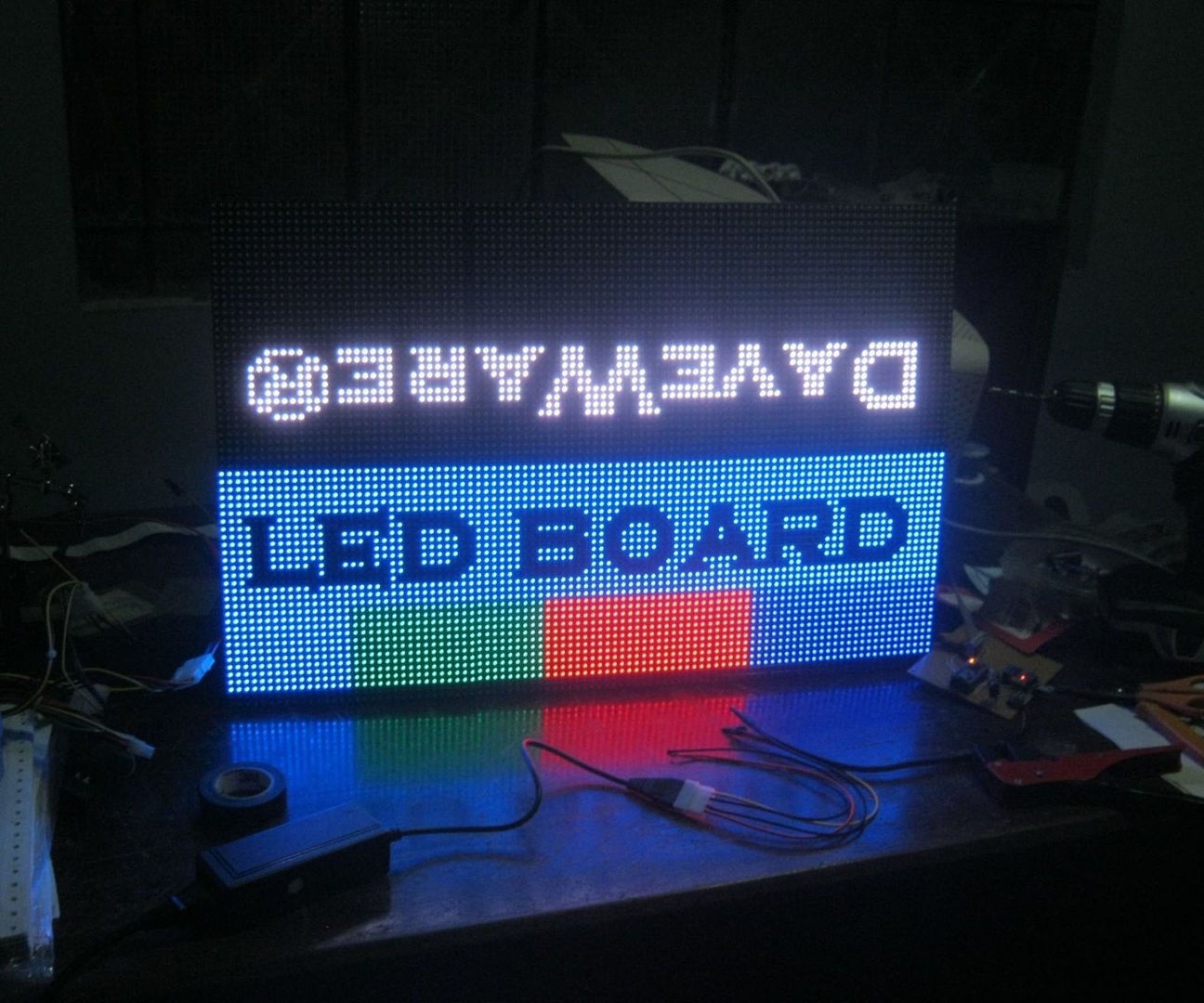

Introduction: Ledboard Pi
Ledboard Pi screen is the result of years of experiences, learning, and development; but also, the result of have the right tools (hardware, software, firmware) in this right moment: Raspberry Pi 4 (with Raspberry Pi 3 works too) with its speed, memory and wireless capaility, the marvelous project Raspberry Pi LED Matrix Display based on the rpi-rgb-led-matrix and rpi-fb-matrix libraries (for driving many commercial RGB LED Panels through GPIO) to show the Raspberry Pi's video output on a large RGB LED matrix display (for this instructable, the resolution is 96x64 using 6 sparkfun 32x32 panels). All these is controlled with a GUI application programmed using lazarus ide on a very light openbox desktop installed over a Raspbian Buster Lite image and finally, show a whatever your imagination can programming: a Multi-Sport Scoreboard, a Digital Signage, or a Video Player; there are no limits. This project, controlled by any computer, capable to run VNC Viewer, because the VNC Server is also installed on Raspberry Pi 4's Rasbian Buster Lite.
From tomorrow, I will try to explain in detail every step to get this project work.

- Now, we are going to test those libraries, remember, rpi-fb-matrix depends on rpi-rgb-led-matrix.
cd rpi-fb-matrix cd rpi-rgb-led-matrix sudo ./demo --led-chain=3 --led-parallel=2 --led-slowdown-gpio=4 --led-gpio-mapping="regular" --led-no-hardware-pulse --led-pwm-lsb-nanoseconds=180 --led-show-refresh --led-brightness=80 -D 0 sudo ./demo --led-chain=3 --led-parallel=2 --led-slowdown-gpio=4 --led-gpio-mapping="regular" --led-no-hardware-pulse --led-pwm-lsb-nanoseconds=180 --led-show-refresh --led-brightness=80 -D 1 runtext.ppm sudo ./demo --led-chain=3 --led-parallel=2 --led-slowdown-gpio=4 --led-gpio-mapping="regular" --led-no-hardware-pulse --led-pwm-lsb-nanoseconds=180 --led-show-refresh --led-brightness=80 -D 2 runtext.ppm sudo ./demo --led-chain=3 --led-parallel=2 --led-slowdown-gpio=4 --led-gpio-mapping="regular" --led-no-hardware-pulse --led-pwm-lsb-nanoseconds=180 --led-show-refresh --led-brightness=80 -D 3 sudo ./demo --led-chain=3 --led-parallel=2 --led-slowdown-gpio=4 --led-gpio-mapping="regular" --led-no-hardware-pulse --led-pwm-lsb-nanoseconds=180 --led-show-refresh --led-brightness=80 -D 4 sudo ./demo --led-chain=3 --led-parallel=2 --led-slowdown-gpio=4 --led-gpio-mapping="regular" --led-no-hardware-pulse --led-pwm-lsb-nanoseconds=180 --led-show-refresh --led-brightness=80 -D 5 sudo ./demo --led-chain=3 --led-parallel=2 --led-slowdown-gpio=4 --led-gpio-mapping="regular" --led-no-hardware-pulse --led-pwm-lsb-nanoseconds=180 --led-show-refresh --led-brightness=80 -D 6 sudo ./demo --led-chain=3 --led-parallel=2 --led-slowdown-gpio=4 --led-gpio-mapping="regular" --led-no-hardware-pulse --led-pwm-lsb-nanoseconds=180 --led-show-refresh --led-brightness=80 -D 7 sudo ./demo --led-chain=3 --led-parallel=2 --led-slowdown-gpio=4 --led-gpio-mapping="regular" --led-no-hardware-pulse --led-pwm-lsb-nanoseconds=180 --led-show-refresh --led-brightness=80 -D 8 sudo ./demo --led-chain=3 --led-parallel=2 --led-slowdown-gpio=4 --led-gpio-mapping="regular" --led-no-hardware-pulse --led-pwm-lsb-nanoseconds=180 --led-show-refresh --led-brightness=80 -D 9 sudo ./demo --led-chain=3 --led-parallel=2 --led-slowdown-gpio=4 --led-gpio-mapping="regular" --led-no-hardware-pulse --led-pwm-lsb-nanoseconds=180 --led-show-refresh --led-brightness=80 -D 10 sudo ./demo --led-chain=3 --led-parallel=2 --led-slowdown-gpio=4 --led-gpio-mapping="regular" --led-no-hardware-pulse --led-pwm-lsb-nanoseconds=180 --led-show-refresh --led-brightness=80 -D 11<br>
All run fine.
- Now, the rpi-fb-matrix library. This will show a portion (96x64) of screen into RGB LED Panels based Ledboard Pi

- Done, you must be able to run Ledboard Pi as well as You see in videos and pictures.
