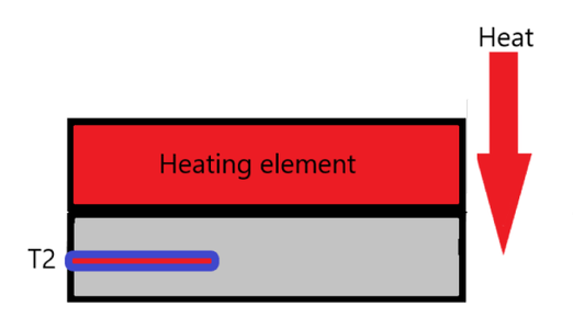

Step 5: Measuring 1
Stack the components like this.
Heat the stack until steady state is reached, steady state is reached when the temperature does not change for around 5 minutes. The accuracy of the sensors is 0.5 °C so these jumps can be ignored.
Record T1 and T2 at steady state.

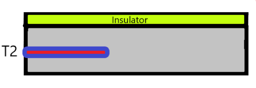

Step 7: Measuring 2
Remove the heating element and place the measured insulator on top of the metal disc.
My results are better when weighing down the insulator with something, here i used a coffee cup.
Allow the metal disc to cool to about 5 °C below its steady state temperature.
Calculate the slope of the cooling curve at the SS temperature of the bottom disc.
