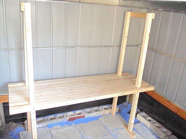

Step 3: Slide Box
When the vise is in use there is not really any weight on the slide (it is distributed through the slide pin to the shelf) so this step could be ignored. I built it mainly because this vise was taking up a lot of storage room (my shed is only 12'x10') and the box allowed me to stack things behind the vise and still use it.
The sides of the box are slightly taller than the slide and is positioned directly behind the back legs. I had some plywood (3/4" I think) lying around so I used it as the box top.

Step 5: Back Legs
I knocked the back legs into place and screwed them in place at the bottom then screwed the back jaw into the bench top and the top of the back legs (make sure you countersink any screws in the jaw face so that they don't bite into your work piece). The angle iron slot I cut in the back of the back legs was tight enough that I just banged it in afterwards.
