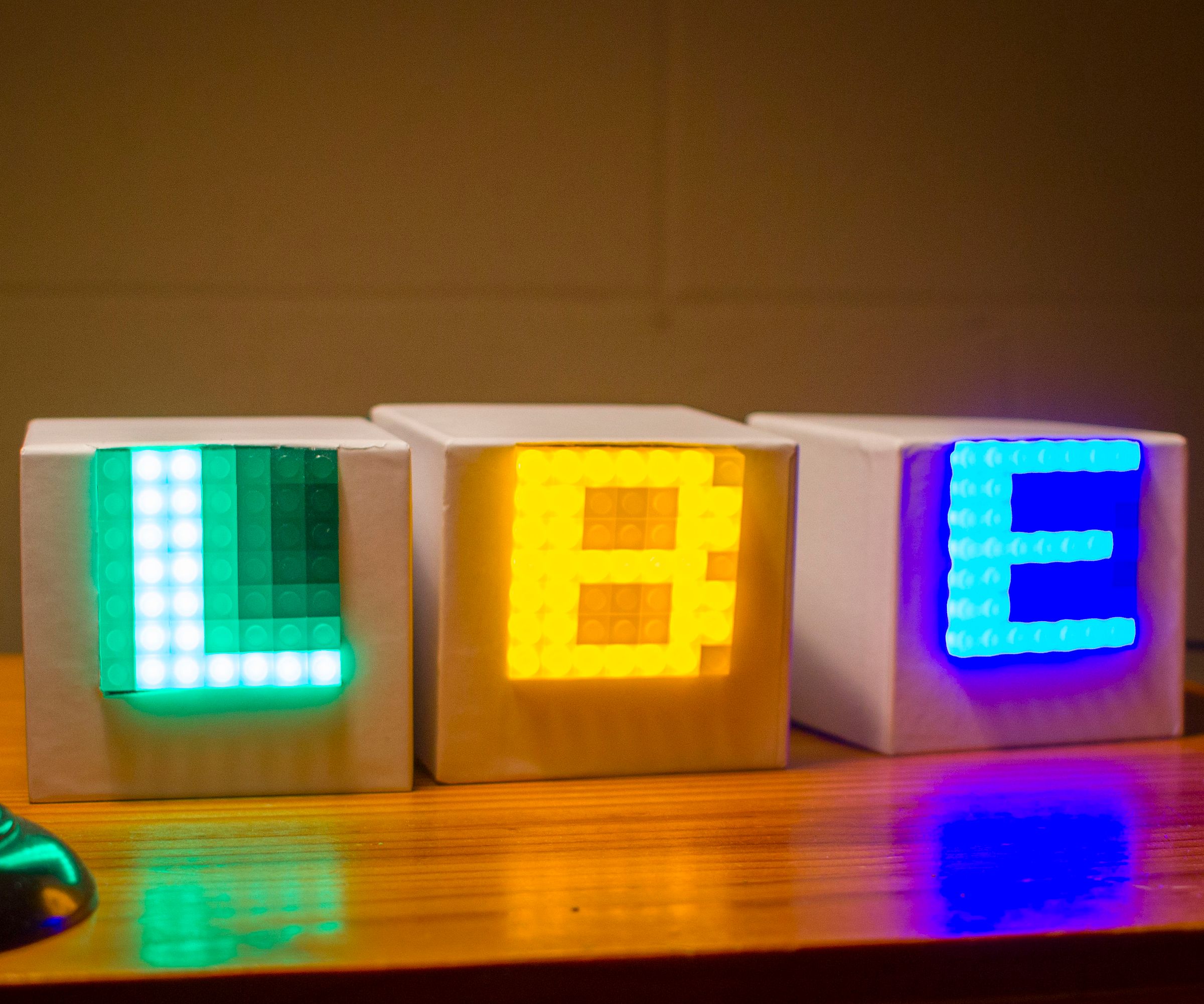

Introduction: Lego Compatible Weather Tracker
The idea with this project was to use a Photon to pull weather data from the cloud, then make it blink some of our Lunchbox Electronics Novelty PTH LED Bricks depending on what data it received. Check out the Lego scene I made for extra pretty decoration.
This tutorial assumes that you have already set up your Photon, a working knowledge of Arduino, and a basic understanding of webhooks.
This project only uses two chips, but it uses A TON of LEDs. Organization is key so that you don't have to dig through a nest of wires as seen in the photo above. Take a look at the schematic for a more organized view.
