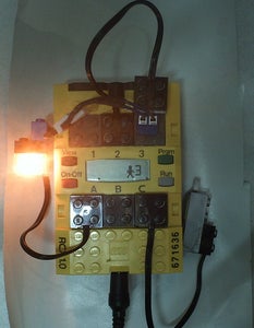

There are plenty of homebrew Lego sensors and motors floating around, but most use a bisected Lego electric cable or an increasingly sparse electric plates with wire soldered to the bottom.

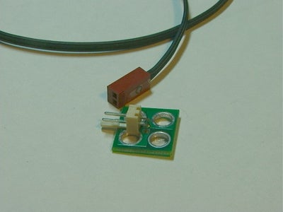

I, on the other hand, wanted a connector that did not use a preexisting Lego electrical connector. I found a nice (discontinued?) female connector, for the longest time I thought female would be easy to make but then it hit me. Metal studs.
I did find a nice female at http://robotics.benedettelli.com/attachment.htm, but I wanted male For in Brick use
They are unbelievably simple and easy to make, and a large number of Lego electric bricks use male connectors.

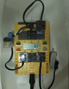

I know with the NXT the RCX legacy connectors are all but obsolete, but I prefer them. They look more Lego and are on the RCX, Scout, Code Pilot, Cybermaster, Technic Control Center, Dacta Serial Computer Interface and the 9V train system.

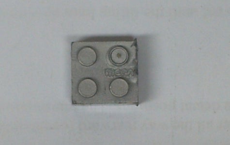

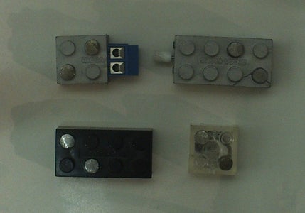

Step 1: Pick a Brick
I used 2x4’s because that is all I really had and they work for most simple sensors and converters.
The brick should have at least a 2x2 section of studs if you want a fully rotatable connection (can clip on at any 90 angle) but a 1x2 can be made to work (like the lamp brick).
Of course a 2x2 flat would make a nice standard cable terminal.

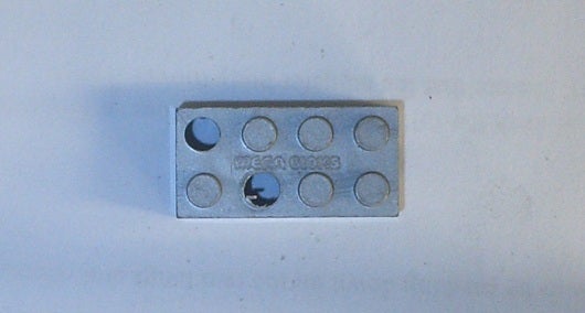

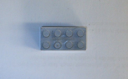

Step 3: Drilling
Drilling is made easy by the fact that, to save plastic, the studs are semi hollow. Without the pilot holes this forms the connector would be incredibly difficult to get right. A drill press is the best for making perfect holes.
The fastest way to hollow out the brick is a large drill bit down the inner poles as far as possible without drilling the top. Then clear the remaining parts with a rotary tool.

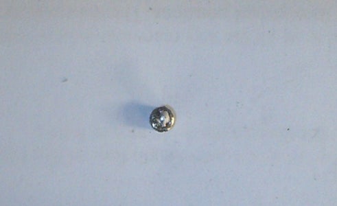

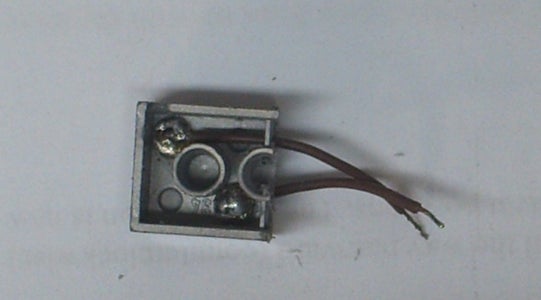

Step 4: Terminals

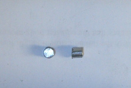

To form a stud file and chamfer the end of your 3/16 rod and cut approx. 3/16 length (.2 in was my usual length)

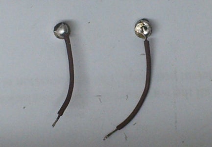

Tinning the wire is easy and will save some frustration.
Tinning the end of the connector takes some time. I first got a glob on the iron and touched it to the unfiled end of the rod. After enough time for the rod to heat up, the glob will flow over the rod end. At that point touch your solder to the rod not the iron and let it flow. At this point, to save time, you could solder on the tinned wire lead.
To insert your new leads just push them through the two holes. I used long nose pliers so I could reposition if necessary. Sometimes going in from the top is easier.
It is best to clip your new connector into a Lego connector and make sure there is continuity. If not use pliers to rotate any lead that is not contacting (always worked for me) then apply adhesive to any loose connector (or all if you wish).
With the wires feed out solder the screw terminal (other connector or PCB) on and glue it into place.

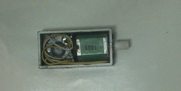

What is more fun than simple I/O devices? Making ones with circuitry inside.
Good uses
Nobody makes just a double sided cable (maybe a really long one), these are for homebrew sensors and motors.
- The LED Brick
- Micro-motor
- Other ideas
- Power Motor Brick
- Adapter brick
- Solenoid
- Sound Brick (original had female connector)
- 12 button keypad
- Capacitor pack
- Switches
- Battery pack
