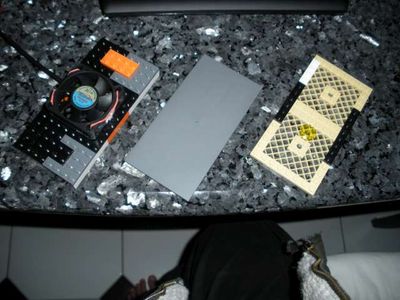

Step 4: Cover Plates
There are 3 cover plates, 1 fan assembly, 1 regular gray plate, and a vent plate. The fan assembly is heightened to assist in airflow. It sits on the far side away from the SATA-USB bridge. Then comes the plain old plate. The vents sit above the logic chips, and lets out the air blown in from the fan assembly. The fan assembly uses a 70mm fan.
