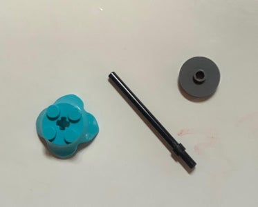

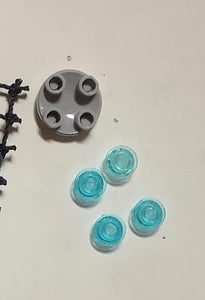

This moving water technique uses a lego net, 2x2 round plates with rounded bottoms, and 1x1 trans round plates (see images 1 and 2).
1) Position the 2x2 round plates with rounded bottom so that the four studs protrude through the net (see image 2).
2) Attach four 1x1 round plates to each 2x2 round plate (see images 3 and 4).
3) Repeat for three more nets (see image 5).

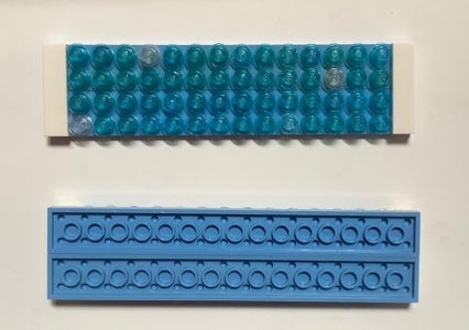

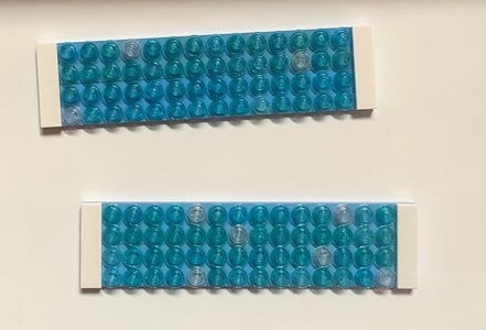

In this step additional water is built to cover parts not covered by the moving water.
1) Attach 1x1 trans round plates to four 2x16 plates (as shown in image 1).
2) Connect two of the 2x16 plates using white 1x4 tiles (as shown in image 2). Repeat for the other two 2x16 plates.
3) Image 3 shows how the fill-in water looks on both sides of the plates.
