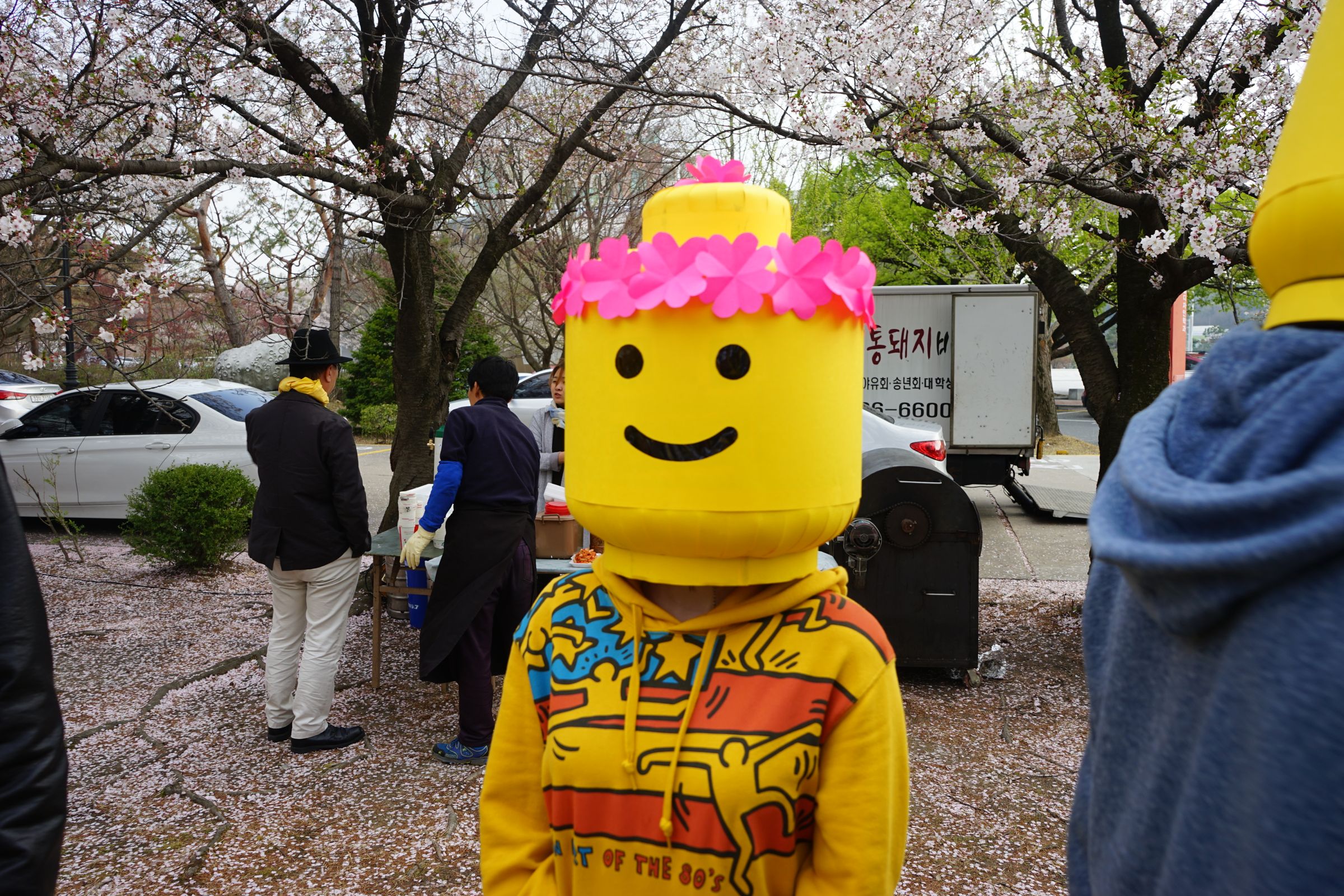

Introduction: Lego Man Head Mask
Have you ever wanted to make a group costume that was easy to manufacture while being good looking? What about if it also uses materials that are easy to find at your local stationary store?
Well, look no more! For a school party, our lab (my Design Lab) decided to go with a Lego theme. As the newest member of the team I was assigned the task of manufacturing the costumes.
We had 7 lab members and little time, so I created a way to manufacture one-size-fits-all masks in a very short time with materials we had lying around.
These masks use a cardboard frame wrapped in yellow papers, and they also have translucent eye-holes, so you don't have to worry about bumping into things. They are very light but also very sturdy and impact resistant - perfect for a party!

Step 5: Finishing
- Attach the NECK band as shown in the pictures.
- Find your favorite Lego man expression, alter it to fit the template and print it. The friend who will be wearing this mask asked for a neutral expression.
- Cut the paper outlines and draw the expression on to the FACE piece. Then cut the outlines on the yellow paper. In this way, if you wish, you can use the same expression for other masks using only one template.
- Measure the dimensions of the translucent paper and cut it to cover the holes. Paste the translucent paper using white glue. I would recommend to not use the hot glue as it will melt the translucent paper. You can also use tape instead.
- Once you are done, it is time for attaching the FACE piece onto the frame. Try to make it so that there is no frame part covering the eye holes. Then start by attaching the end of the band and continue with the rest of the piece.
You are ready!!! Now you have your own Lego Man Head Mask.
Step 6: Variations and Final Thoughts
As you can see from the pictures, we made 7 masks in total.
Each of us had a different expression.
Another interesting thing about the masks is that they stack onto each other. During the party dinner, we hanged the masks on a nearby tree. It was used as a photo shoot place.
