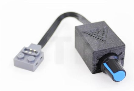

Inspired by this product I made my own versions of a speedcontroller for Lego PF motors.
I made also another version of a Lego speed controller based on an Arduino ProMini (or clone), a Rotary encoder and a 16 LED Neopixel Ring as forward/reverse speedindicator.

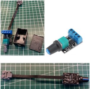

This product contains a commercial HW-70 PWM Motor Speed Controller Module.
It is based on the well known NE555 timer-IC to make a PWM ouput signal.
I bought a couple of these modules on AliExpress (for approx. 1€20 each incl shipping).
Step 1: 3D Print the Enclosure (small Module)
Then I made a small snapfit enclosure for it in FreeCad and 3D printed it.
The cable entry on the lid is marked with "wire".
The bottom (= lid) fits on lego studs.
You can find the the native files on my github

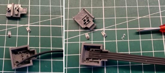

Step 2: Make Lego PF Connection Cable
On AliExpress I bought a couple of PF connectors and 4 core wire and made my own DIY Lego PF connection cable.
Before assembling the PF cable, I removed the C1 and C2 contacts from the Bottom part of the connector so that only 1 connector is required to connect both the battery box (via the 0V and 9V contacts in the BOTTOM part) and the motor (via the C1 and C2 contacts in the TOP part).
See here the working of de Power Function cable

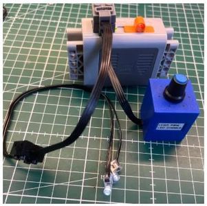

Step 3: The Result - LED Dimmer
Because the output voltage cannot be reversed with this version, this module is actually more suitable as an LED dimmer than as a speed controller for a motor.

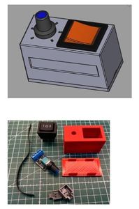

For this version I designed a larger snapfit enclosure in FreeCad

Step 6: 3D Print the Enclosure (Large Module)
Finally I 3D printed the enclosure and mounted the circuit into this housing.

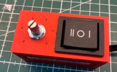

To make the stripes on the potentiometer scale, color in the lines with a black marker and then wipe it clean with alcohol, leaving the stripes.
Step 7: The Result - Motor Speed Controller
The result is a full function speed controller for Lego PF motors.
The bottom (= lid) of the module fits on lego studs.
