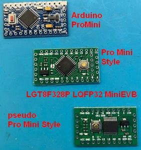

For the Arduino boards both the Arduino ProMini and the cheap LGT8F328P LQFP32 MiniEVB (Pro Mini Style) can be used or even the very cheap LGT8F328P SSOP20 MiniEVB (pseudo Pro Mini Style).
Some time ago I bought a whole bunch of LGT8F328P MiniEVB modules on AliExpress for less than €0,70 each - I used the 5V version, because not all types of Neopixels are compatible with 3V3.

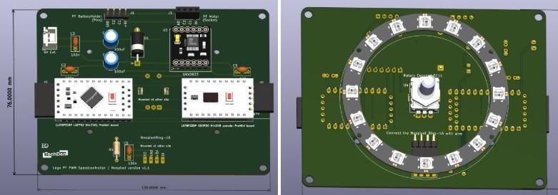

Step 2: The PCB Design
Finally I designed a 76x100mm PCB, which I ordered from JLCPCB. So I have now 5 boards of which I can give away (or sell) 4 pieces to relatives :-).
The pcb design takes into account the footprint of the different Arduino boards, however only 1 of the Arduino boards needs to be placed.
You can find the the gerber files on my github.

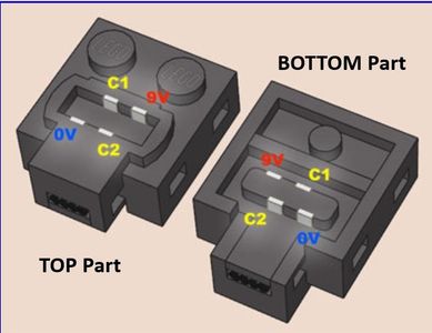

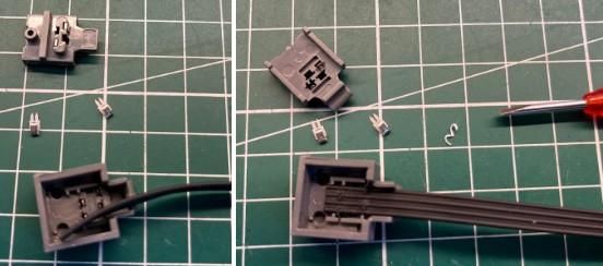

Step 3: DIY PF Cable
On AliExpress I bought a couple of PF connectors and 4 core wire and made my own DIY Lego PF connection cables.
Before assembling the Input PF cable (connected to J11 in the schematic), I removed the C1 and C2 contacts from the Bottom part of the connector so that this connector can be used to connect both the battery box (via the 0V and 9V contacts in the BOTTOM part) as the Lego PF-motor as well (via the C1 and C2 contacts in the TOP part).
The output PF cable (connected to J13 in the schematic) is not modified (so has all its contacts).
So the PF-motor can be connected or to the input connector (connected to the Battery box) or to the output connector.
See this article about the working of de LEGO Power Function cable.

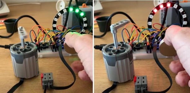

  1. The Neopixel ring indicates the output signal (similar to the big yellow button on the conventional Lego train speed regulator).
  2. Turning the Rotary encoder knob to the right wll increase the speed in forward direction (Green color), turning to the left will decrease the speed to 0 (LED8 is the center of the indication scale) and then increases the speed in reverse direction (Red color).
  3. Neopixel LED0 is set to blue as power-on indication.
  4. When your Rotary encoder is equipped with a push button; a short button press will increase the brightness of the LEDs (in 9 steps) and a long button press (>2sec) will reset the brightness to the default 10% and set the speed to 0 (Stop).

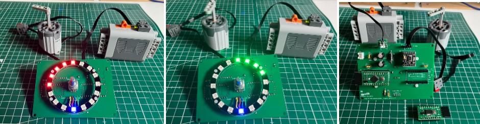

Step 5: The Assembled Board
And this is what it looks like when the board is assembled and tested.

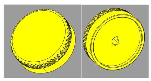

Step 6: Yellow Knob & Enclosure
I designed a big 45mm knob in FreeCad (v1.0) for the Rotary encoder and 3d printed it in yellow
The design is parametric - so the knob dimensions can be modified (spreadsheet tab)

Step 7: The Final Result
And this is how it looks like after assembling all the parts
