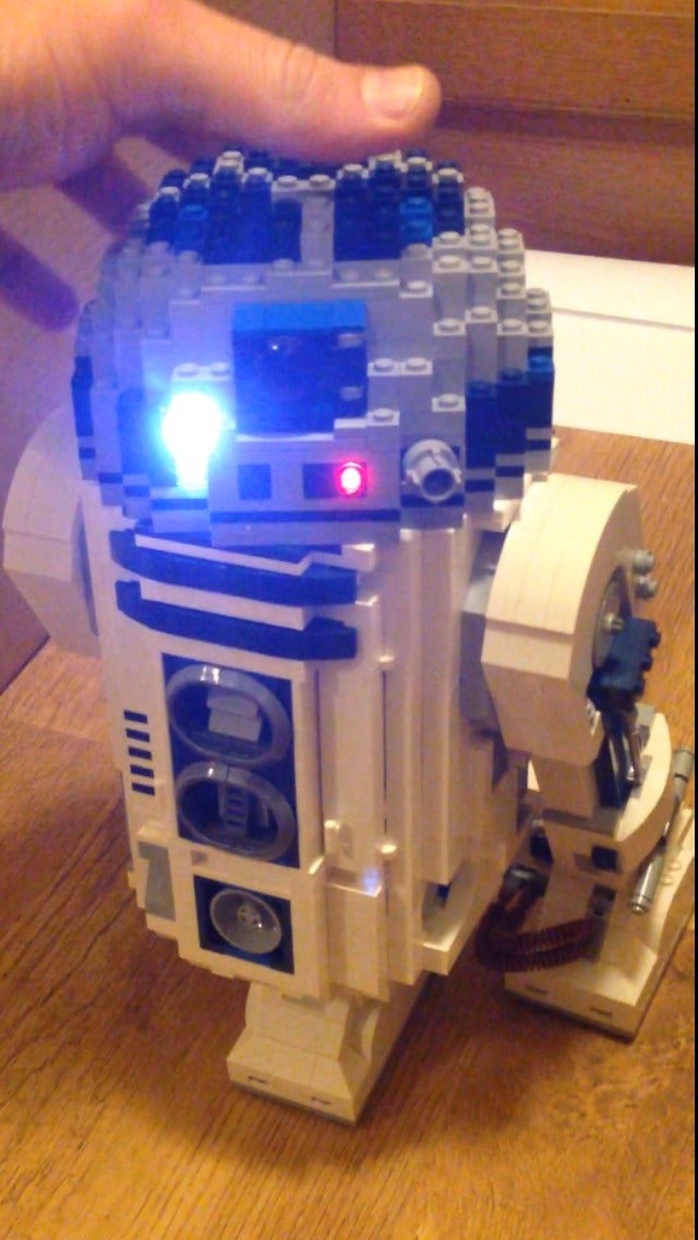

Right you should have a working sound chip in your possession about now. All that's left to to is figure out how you're going to mount it inside the Lego R2. Again I'm sorry for the lack of detail with this.
Firstly I had to figure out how to operate the sound chip without having any external wires showing. I decided to make a push button switch which used an existing part of the Lego R2. This switch is sprung loaded so it only presses the pressure pad on the board once. Similar to when you squeeze R2's tummy to make the noise.
One you're happy with the switch you can add the LEDs. Basically I made up some led looms and figured out where to solder them so they came on when R2 spoke. Trial and error with this one I'm afraid but you can't hurt anything by touching wires onto points. It will either work or it won't lol!
Now the LEDs are sorted you need to get it all glued in and wires tidy. The LEDs sit nicely behind the Lego pieces so this built was crying out to be done to be honest. Everything fit perfectly without too much disturbance.
