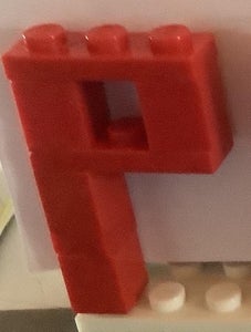

Step 1: Lego Lettering
The lego lettering for PRIDE 2021 fits across 32 studs which allows for 1 to 3 studs per letter/number.
The letters are shown in photo 1 and the numbers in photo 5. Below are the specific directions for each letter and number:
Letter P (Red- 3 studs) - photo 2
1) Place 2 - 1x1 bricks and 1 - 1x1 plate on top of one another in stud 1
2) Position a 1x3 plate on top of step 1 so that it spans studs 1 - 3.
3) Position a 1x1 brick on top of the 1x3 plate (step 2) on stud 1 and on stud 3.
4) Position a 1x3 plate on top of the two 1x1 brick.
