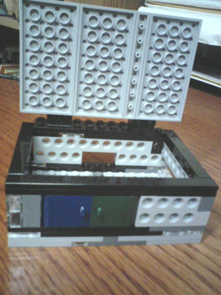

Thank you very much for your work on this. I have made 10 enclosures, using your instructions. However, I have modified the roof. Instead, the roof is connected to a hinge, so that it opens (for GPIO access, etc...).
Reply 9 years ago on Introduction
Here are some instructions for adding my modified hinged roof, if you'd rather not use the round corner plates. Follow darrennie's instructions through "Step 5: Header."
(I) You need the following parts for this hinged roof:
4 -- 1x2 Plate Modified w/ Clip on Top - #92280
4 -- 1x2 Plate Modified w/ Handle on End (Closed Ends) - #60478
2 -- 1x1 Tile - #3070/3070b
1 -- 1x4 Tile - #2431
3 -- 1x8 Tile - #4162
1 -- 1x8 Plate - #3460
1 -- 2x10 Plate - #3832
3 -- 4x8 Plate - #3035
1 -- 4x10 Plate - #3030 (or you can use two 2x10 Plates)
(II) Place the Tiles and the 2x10 Plate on top of the "Header," as shown in the first attached picture (according to the point-of-view indicated). Notice that one of the two columns of the the 2x10 Plate will hang over the edge of the case.
(III) Place the 1x2 Plates with Clip on the 2x10 Plate from step (II) above, as shown in the second attached picture.
(IV) Now for the very top: on a flat surface, line up the three 4x8 Plates with the 1x8 Plate, as shown in the third attached picture.
(V) Attach the 4x10 Plate, as well as the 1x2 Plates with Handles, to those plates from step (IV) above, as shown in the fourth attached picture.
(VI) Now attach the handles to the clips, and you've got yourself a hinged roof!
