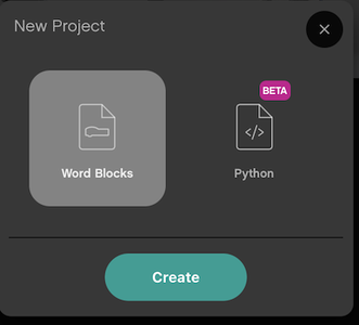

3. Select Word Blocks and then Create.

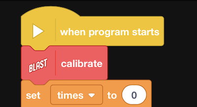

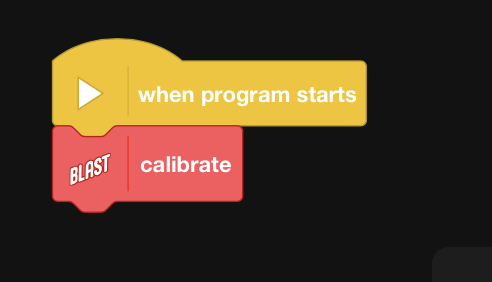

1. When starting a new project - the code line "When Program Starts" is automatically inserted.
2. Drag "Blast Calibrate" from the Model Blocks category. Insert it under the first line of code and allow it to attach (see image 1). This code resets Blast so that all motors are in a neutral position and all sensors are cleared.
This code will have one variable which keeps track of the number of times that our modified Blast changes directions.

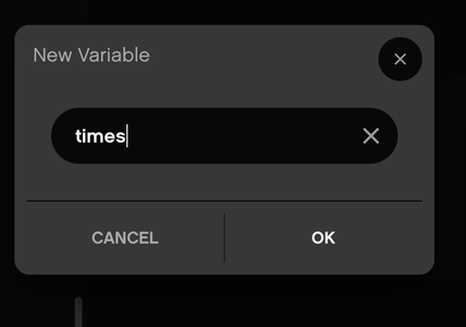

1. Click on the Variables category and click on "Make a Variable" (see image 2).
2. In the dialog box that appears (see image 3) type the name of the variable "times" (see image 4) and click OK. Now the variable (see image 5) is available for use.
3. Prepare the variable by dragging "Set timer to" from the Variable category under the "Blast Calibrate" code line (see image 5). Type the value you wish to assign to the variable in the white circle. For this project, type "0" so that the variable can start from zero recording the number of turns. The "Set times to" and the "Change times by" code blocks appear under the Variables Category after you have created a variable.

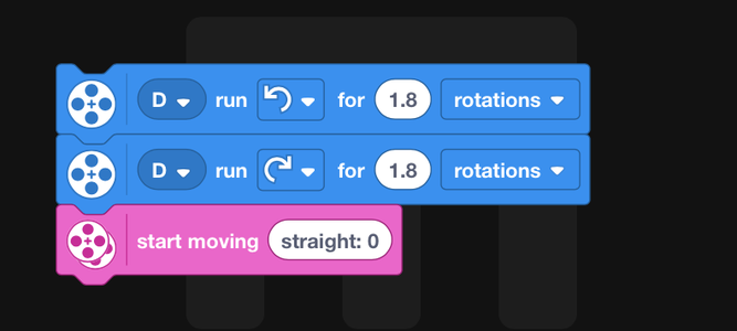

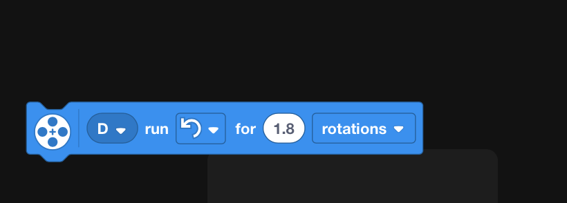

3. Motors can also work individually using the code blocks from the Motor Category. Drag " run for" (see image 4) from under Motor Category to under the code lines. Then, repeat so that you have two " run for" code lines (see image 5). There are four choices to make for this line of code. The first choice is the selection of the motor. In this case select D for motor that controls both arms and the neck. The second choice is whether the motor moves clockwise or counter-clockwise. For the first line of code choose counter-clockwise and for the second line of code choose clockwise. This will direct the arms to move in one direction and then the other. The third and fourth choices code the amount of movement. For the fourth choice, the options are rotations (we will select this one), degrees, or seconds (amount of time). For the third choice, type 1.8 n the circle for both lines of code so that the arms return to the starting position.
4. Start the legs moving by dragging "Start moving" from the Movement Category to the bottom of the code (see image 5). Next select the direction you want the robot to move by clicking on the drop down menu (see image 6). Select straight.

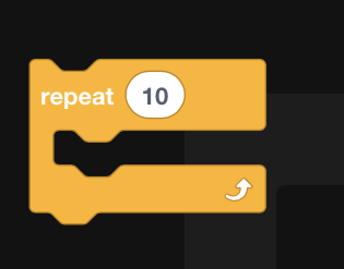

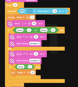

1. Drag "Repeat" (see image 1) from the Control category. This will be the main section of the program and all other word (block) code lines go inside the two horizontal bars. Type the number of times you wish for the program to run in the white circle. Type 10 as a starting point; you can always raise or lower this number.
Blast will continue to move forward (based on the line of code prior to the "repeat"). However, we want Blast to stop, reverse, turn (right or left) whenever it encounters an obstacle, and continue moving forward.

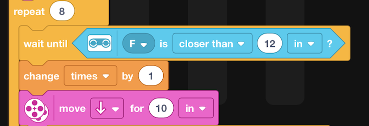

1. Drag "Wait until" (see image 2) from the Control category to inside the "Repeat" loop. Then, drag " is " closer than" (see image 3) from Sensor Category. There are four options here. For the first choice, select F (distance sensor). For the second choice, select "closer than" (selected by default). For the third choice and fourth choice, select the the distance that Blast is waiting for. Type in 12 and select inches (see image 3)
2. Once Blast is closer than 12 inches from an obstacle, it needs to react with a turn. Knowing that a turn is coming up, drag "change times by" from Variable Category. Type 1 in white circle (see image 4).
3.Before turning, it is a good idea for Blast to back up. Drag "move for" (see image 5) from Movement Category to the bottom of the code list (see image 6). There are three choices here. For the first choice select backwards. For the second and third choices, type in 10 and inches.
Tip: As your code gets longer you can move up and down by clicking in the black area and dragging.
Step 7: Write Code: If Then Else
The only question left is which way to turn: right or left. We would like to alternate the turning in the following pattern: left, right, right, left and repeat. This pattern helps to keep Blast from getting stuck in a corner. So, if the "times" variable is 1 or 4 Blast should turn left. If the "times" variable is 2 or 3 Blast should turn right. Once Blast has gone through left, right, right, and left turns, then the variable "times" should be reset to zero.

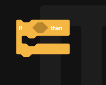

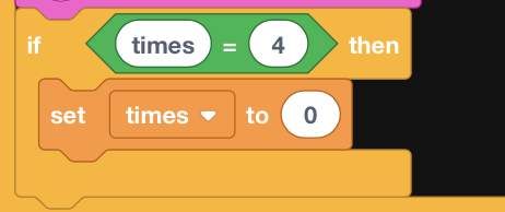

1. Drag "If then" (see image 1) from Control Category to inside the "Repeat" loop after the code already included. There is one choice for this code block - if what? Drag " =100" from Operators Category into the choice box after the if statement. In the first white circle type the variable name "times". In the second white circle, change the number to 4 (see image 2). The test here is to determine if four turns have occurred.
2. Drag "Set times to" from the Variable Category between the two horizontal bars of the If statement (see image 2). Set the number in the white circle to 0.

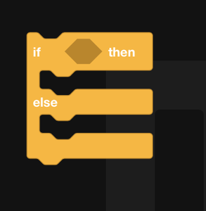

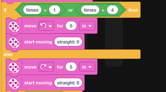

3. There is also a "If then else" (see image 3) Word Code line in the Control Category. Drag it inside the "Repeat" loop directly above the "If then" loop. This loop is used to determine whether Blast turns right or left. Drag the "or" word (code) block from the Operator Category to the area after the word "If" (see image 4). Type times in the first and third circles and 1 and 4 in the second and fourth circles.
4. Drag " move for" from Movement Category to under the If loop (see image 4). For the first choice select turn left arrow. For the second and third choices, type in 5 and select inches.
5. Drag "start moving" from Movement Category to under the "move for" code line (see image 4). For the choice, select straight. This code line will be repeated for right turns, so it could go outside the "if else" loop but still inside the repeat loop. I felt putting it twice (although not best practice for coding) would make the code easier to read.
6. Drag " move for" from Movement Category to under the else loop (see image 4). For the first choice select turn right arrow. For the second and third choices, type in 5 and select inches.
7. Drag "start moving" from Movement Category to under the "move for" code line (see image 4). For the choice, select straight. Again, since this code line is being repeated, it could go outside the "if else" loop but still inside the repeat loop. However, I felt putting it twice (although not best practices for coding) would make the code easier to read.

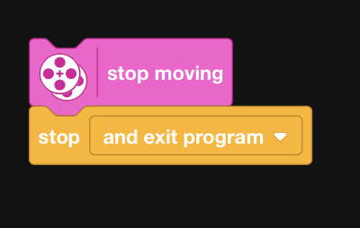

The second to last step is to stop the leg motors from moving by selecting "Stop Moving" from Movement Category.
The last step is to stop and exit the program by selecting "Stop" from Control Category. Then, click drop down menu and select "and Exit Program".

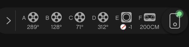

2. Click hub icon in upper right hand corner (see image 1) and follow the on-screen directions to complete the connection sequence.
3. I like to put my robots (see image 2) on lifts (see image 3) during initial testing.
4. Click on start icon (see image 4) in the lower right hand corner.
5. The live update in the upper right hand corner (see image 5) assists with debugging by providing information on the status of the sensors and motors.
