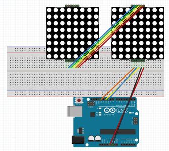

Step 2: Step 2: Wiring
- Connect the 5V on the arduino to VCC on the matrix
- Connect the GND to the GND
- Connect input5 to CS
- Connect input6 to DIN
- Connect input7 to CLK
For all of the inputs, you could change the wiring on the arduino as well as on the code to make it functionable. You do not have to use the same CS, DIN, and CLK which I have chosen to use in my arduino project!
The wiring picture drawing in the picture was gotten from CarterW16 so I do not own any credits for it.
