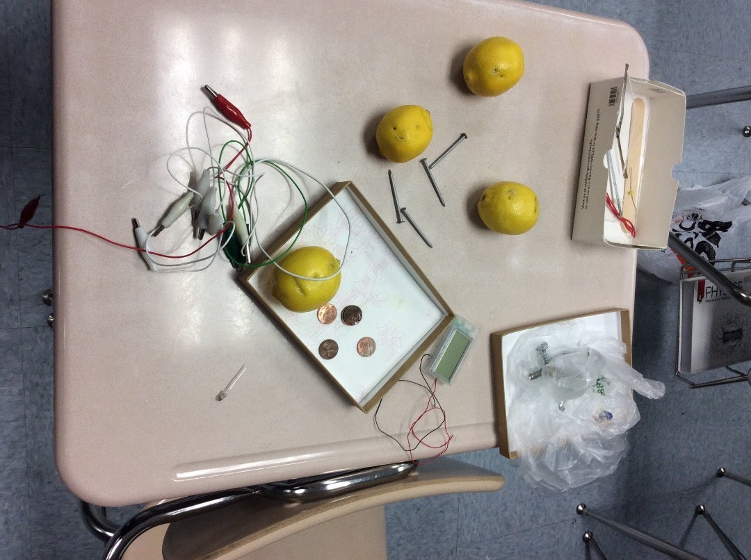

Gather
-Four lemons
-Five alligator clips
-Four pennies from before 1982 so they're copper plated.
-Four galvanized (iron coated) screws or nails.
(Screws are featured in this picture that were used, but were found not to be galvanized and ended up using galvanized nails to complete the project)
-A blue LED that requires 3V of electricity
-Clock is optional to show further signs of electricity generated

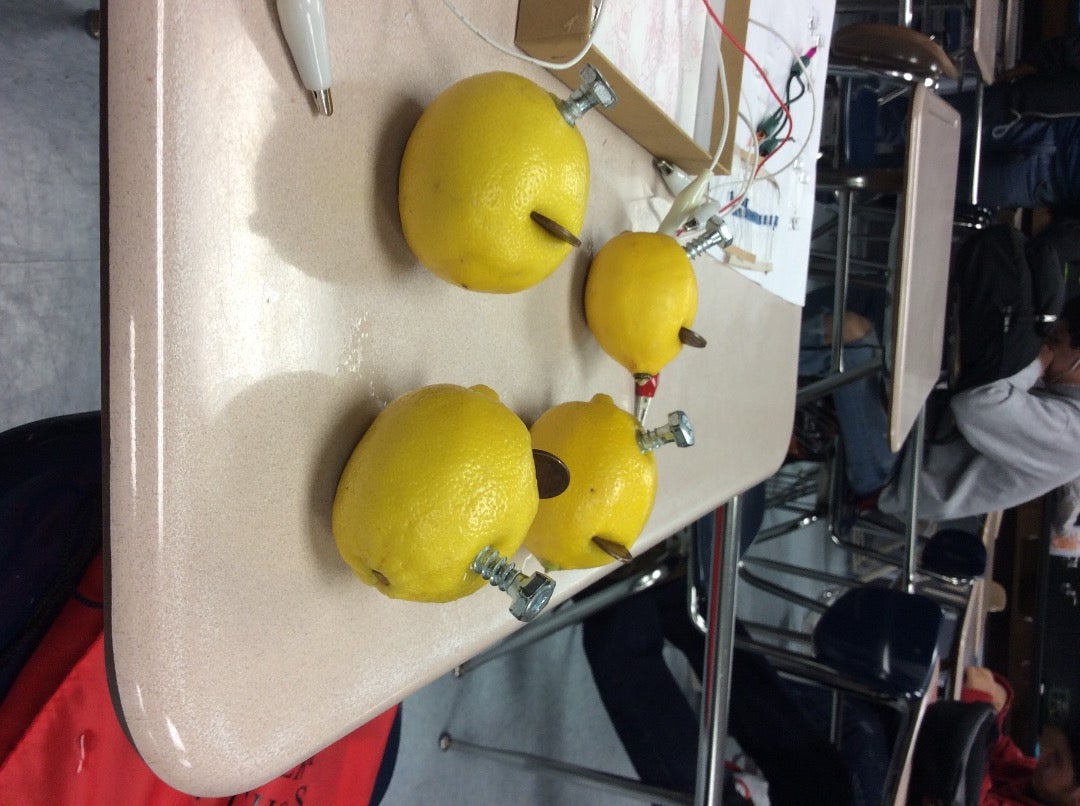

Step 2: Placing Screws/Nails in Pennies
Take the lemon and slit a small hole in each side parallel to each other for the screw/nail in lemon (screw in picture, but later used nails).
Place one nail, me one screw parallel (about an inch part) in each lemon.
WARNING THIS WILL BE MESSY.

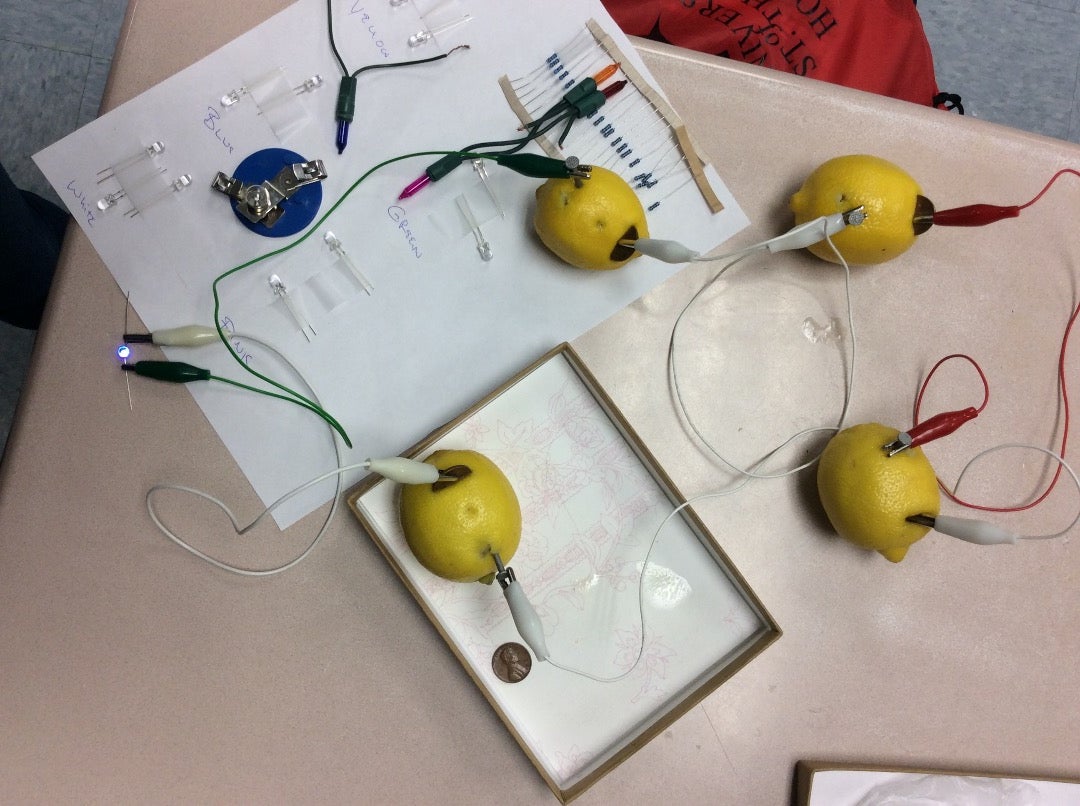

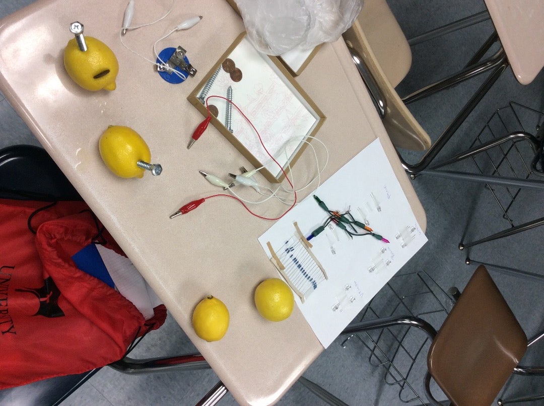

Step 3: Begin Connections
Connect an alligator clip to the screw/nail from one lemon, to the penny from a separate lemon in order to begin the conduction of electricity.

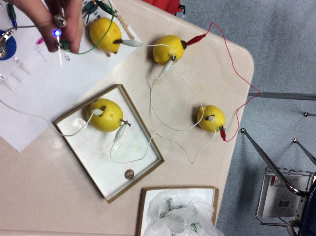

Step 4: Connect Alligator Clips From First and Last Lemon to LED.
Separate flaps on LEDs to point in opposite directions and take the alligator clip from the last lemon that is connected to the screw/nail and place it on the left side of the LED.
Then take the empty alligator clip from the first lemon (should be connected to the copper penny) and then clip it on the right side of the LED.
The LED should glow at this point, producing around 5V of electricity with four lemons.
If LED does not flow, check connections and make sure opposites are paired.
