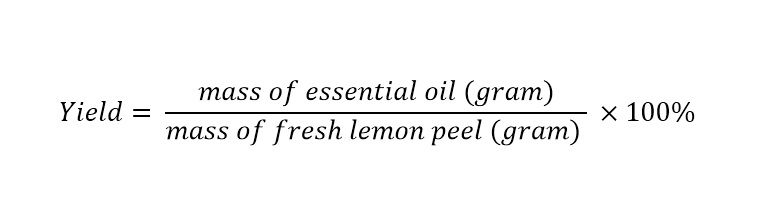

Measure the volume of lemon peel essential oil that we get. Not only volume, but also we have to measure the mass of oil. Why we have to measure the mass? Because we want to know the yield of the lemon peel essential oil.
In the beginning we know that we have 1 kg of fresh lemon peel. After we separate oil and hydrosol, we measure the mass of lemon peel essential oil which is 9 g. Based on the formula above, now we know that the yield of lemon peel essential oil is 0.9%.
