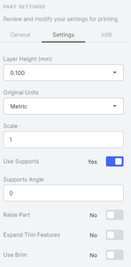

Then, I uploaded the files into a Slicer. I used eiger.io because I printed from a Markforged Mark 2.
I made sure to orient the handles so that the channels are facing upwards. This will ensure the best print.

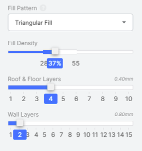

I edited the default print settings on the application to best suit my prints. One balisong trainer requires 2 handles and 1 blade, which I printed at the same time on one build plate.

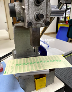

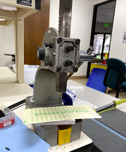

Then, I stuck a small magnet to the bottom of the metal ram of an arbor press. I attached a 3/32'' pin to the bottom of the magnet so that the pin faced downward. This pin is the zen pin.

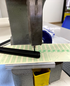

I lined up the handle under the zen pin and magnet. Then I slowly pressed down on the ram of the arbor press to gently press the pin into the handle.
I made sure to be extremely cautious during this process because too much force from the arbor press could easily shatter the handle.
I repeated this step for the 3/16'' pin for the bottom hole of the handle. This pin acts as the weight pin to add weight to the overall handle.
I repeated these steps again for the other handles. The ending result were two handles with the zen pins and weight pins successfully pressed in.
