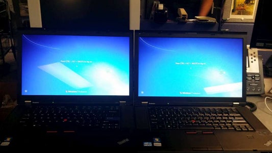

There were 2 laptops that were turned back in on our last refresh that had some dead spots in the back light. As you can see by the picture the laptop on the left has been replaced, the laptop on the right is the one that I am going to replace the display in the video. I figured that as we had 2 out 15 that there are probably more people out there that are experiencing the same issue.
