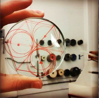

Step 2: MARKING
Use a sharpie marker to trace the location where you'd like your lenses to be. It's always best to draw a circle slightly smaller inside to avoid carving the outside cercle.
In order to stay perfectly circle use a sharpie to mark the cercle. The water and friction will take the sharpie off after a while so it's absolutely normal if you spend more time marking then carving at first.
After lots of practice your eye will get more and more trained and you will be able to carve a circle without using as many marks.
