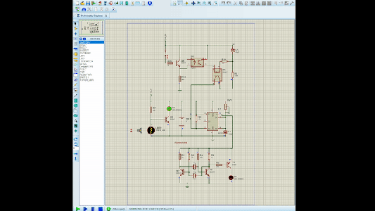

Step 3: Intruder Alarm Section(1)
Diagram 1: In this part, when the door is closed the switch is also closed. At this moment the Q4 transistor is ON and thus current cannot flow through the U4 optocoupler. This allows the 47uF capacitor to charge as shown in the first diagram.
Diagram 2: When the door opens the Q4 transistor stops conducting. The U4 optocoupler is now active, it closes the connection between the second optocoupler and the capacitor. This enables the U5 optocoupler to run for a short time through a 100ohm resistor. This eventually creates a pulse that is sent to the NE555 circuit.
Diagram 3: after a short time, the capacitor is completely discharged. the U5 optocoupler stops conducting and no further signal is sent to the multivibrator part.
The whole process is repeated when the door is closed again.

Step 8: Simulate the Circuit
When the door opens, the capacitor discharges, and the buzzers beep twice, and when door is closed the capacitor gets charged.
Check the attached simulation file, tweak the circuit to build more interesting outputs!
