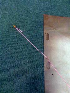

I found this laminated chair back from a chair that had seen better days...
Step 1: Planning Out the Shape
The curves are actually easy to create using a string, a pushpin and a pencil.
You first need to find the center of the piece for this kind of curve.
Step 2:
Once everything is drawn out, it's time to hit the saw. I have access to a nice bandsaw, but a jigsaw or coping saw will work the wood nicely.
