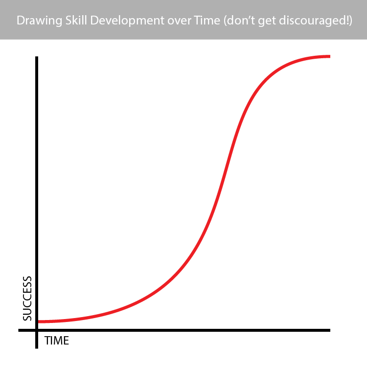

Drawing can be uncomfortable in the beginning- it's very rare that a person can just sit down and do it without a lot of practice. The curve for you might look something like the diagram above. In the beginning your drawings probably won't look great, but with every new drawing you'll notice them coming out the way you want them to more and more often. After enough practice, the techniques you'll learn here will be second nature, and you won't even have to think about them. In the meantime, follow the rules taught in this lesson and you'll get better results earlier.
