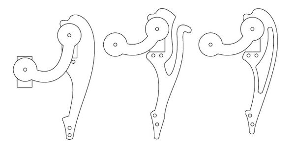

See the first picture to get a glimpse of how we are going to connect our robot's joints. I found that picture on the web. In the second picture you will understand the walk pattern of our robot. Very simple ? This pattern is going to make our robot walk.

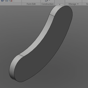

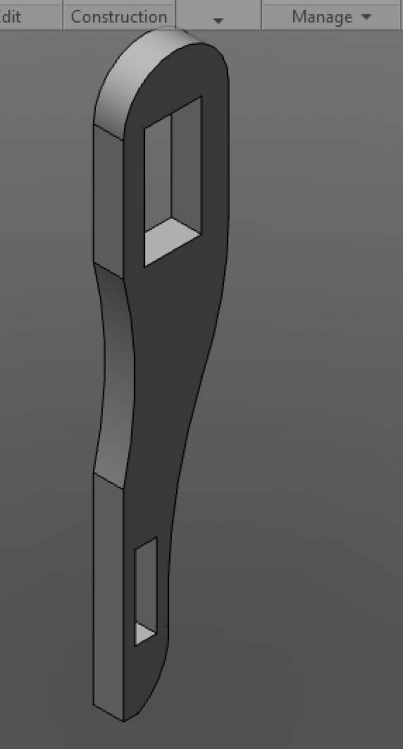

Step 3: Autodesk Inventor Drawings and Design of Our Robot
This part is up to you.
You can change its shape, body, size and everything. Don't forget to be proportional. Also be careful! each leg of your robot must touch the ground from one point, I made it with two points and it is increasing friction, which you don't want to have.
Also consider the size of your servos and create the servo holes accordingly.

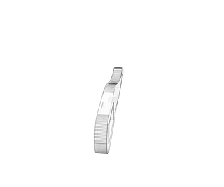

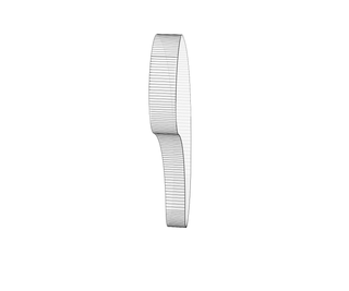

After modeling your robot print the front, top or right views of the parts in the exact sizes. We will use them in the next step with copy paper.
I uploaded my 3D drawings in stl. formats.

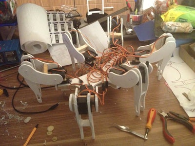

Step 5: Preparation of the Legs
As you can see from the pictures, build the legs. But don't forget my mistake! Your legs should touch the ground from one point.
Glue the parts and attach them together. Use kite woods in the necessary weak points that you have observed.You will notice that servos are connected to joints from bots ends. You will see how I do it in the next step.
Of course you should prepare six legs :) In the picture you can see six legs. But there servos on each. What ? don't worry. I will come to that point in the following steps. Just create legs with one servos.

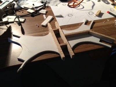

Step 7: Preparing Main Body
By using your own drawings from the inventor and after printing necessary front, top or right views, draw them on top of PVC foam board with the help of copy paper. Later cut it out. Of course you should do it twice and put kite woods in between plates for creating a strong body.
