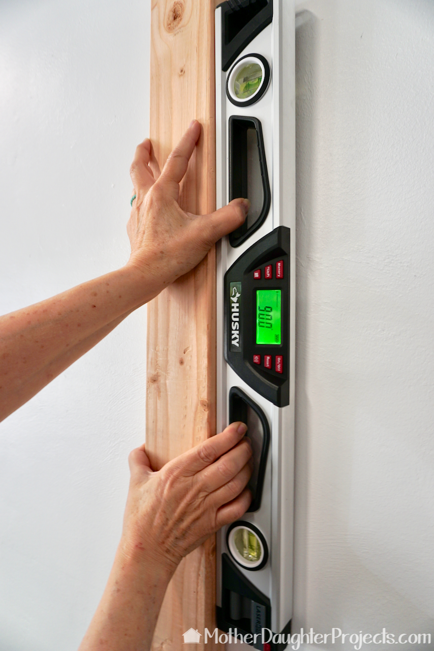

Step 7: Add in the Studs
With the bottom and top plates in place, it was now time to put in the studs. The first one was nailed to the existing side wall. The level showed the stud was perfectly straight!
Okay, you're probably asking why we used those plate things rather than the traditional toenailing technique. Well, frankly, with our skill set and strength we could not physically do it. Through some research we found an alternative way to attach the studs to the bottom and top plates. These Simpson Strong-Tie stud plates were just what we needed.
We used a Ridgid pneumatic palm nailer with a Ridgid compressor to drive the nails. This was easy AND fun! This tool drives the nails with ease.
