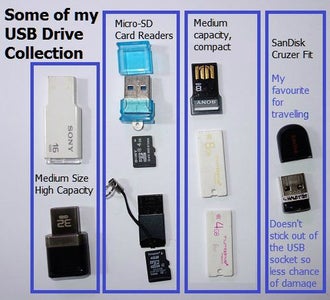

Step 2: What You Need
  1. Access to a PC (your regular home PC).
  2. An internet connection for downloading the software.
  3. A 2GB or 4GB Thumb drive/USB drive/ Flash drive/Pendrive - whatever they call it in your country. I will use "USB drive". Your old 2GB micro-SD card may not be much use on your new smartphone, but you can load and run Linux off it using a USB card reader (see the picture).
  4. Optional - Your old laptop or PC that was made redundant by the arrival of Windows XP or Windows 7. We will revive it with Linux.
  5. A basic understanding of how Windows works, file handling copying files and filenames, moving files, etc. Knowledge of how to enter the BIOS for your PC would help speed things up.
