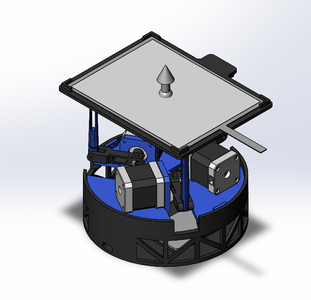

Step 1: Designing the Robot
This robot is a 3-RRS parallel manipulator, meaning each of its three legs has:
  1. A revolute joint that's motorized
  2. Another revolute joint connecting the lower arm to the upper arm
  3. A spherical joint connecting the upper arm to the platform
The basic idea is to place three of these arms in an equilateral triangle so the platform gets 3 degrees of freedom:
  1. Rotation along the X axis
  2. Rotation along the Y axis
  3. Translation along the Z axis
Design Considerations:
  1. Stepper motor placement must form an equilateral triangle
  2. Must leave space to house electronics
  3. A top platform to mount the arms and hold the touchscreen
  4. The entire structure needs to be stable
I used Solidworks to model all parts and 3D printed them using PLA. My files are attached, but I highly recommend you try designing your own parts if you're up for a challenge, as it's a great opportunity to improve your CAD and problem-solving skills! (Note, the full assembly file cannot be uploaded on this site, but is available on my Github page)
Once your parts are designed, go ahead and 3D print them. Now it's time to start building!

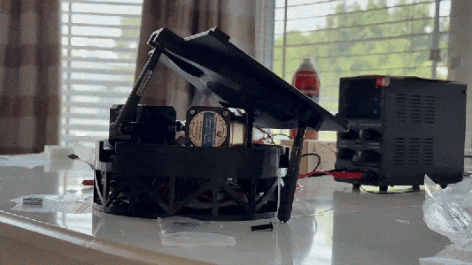

Step 3: Assemble the Robot
By now, your 3D printed parts should be ready to go!
Start with the Screen Plate
  1. Attach the tie rods to the upper legs using an M3x8mm screw
  2. Use two M3x5mm spacers per leg to mount to the screen plate
  3. Use M3x18mm screws on each side of the hole
Build the Base
  1. Slide the 3D printed motor spacers onto each motor
  2. Mount motors with M3x10mm screws, wire side facing inward through the center hole
Note:
Stepper motor wires are ridiculously long, so zip-tie them neatly to keep things clean.
  1. Attach wires to the motor drivers, keeping wire orientation consistent
  2. Keep track of which motor correlates to which driver correlates to which Teensy pin (order matters!)
Final Steps
  1. Attach lower legs to motors with M3x25mm screw and nut
  2. (Make sure the triangle side faces up)
  3. Secure the circuit board to the base
  4. Connect upper legs to lower legs
  5. Motor A should be at the top of the triangle, the side that sticks out over the touchscreen
