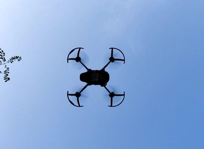

Step 7: Let's Fly It!!!
Now that the assembly, setup and calibration are done, we are ready to fly our Pluto.
  1. As a beginner, find an open space. Outdoors is fine if it is not very windy. Or an empty room.
  2. Place the drone on the floor or a table. The surface should be flat.
  3. Next, on the app, toggle the Arm button. And finally hit the Takeoff button.
Now you can control the drone using the app as a controller. Apart from the app, we can also use an external gamepad controller to fly the drone, but we will see that in another instructable.
