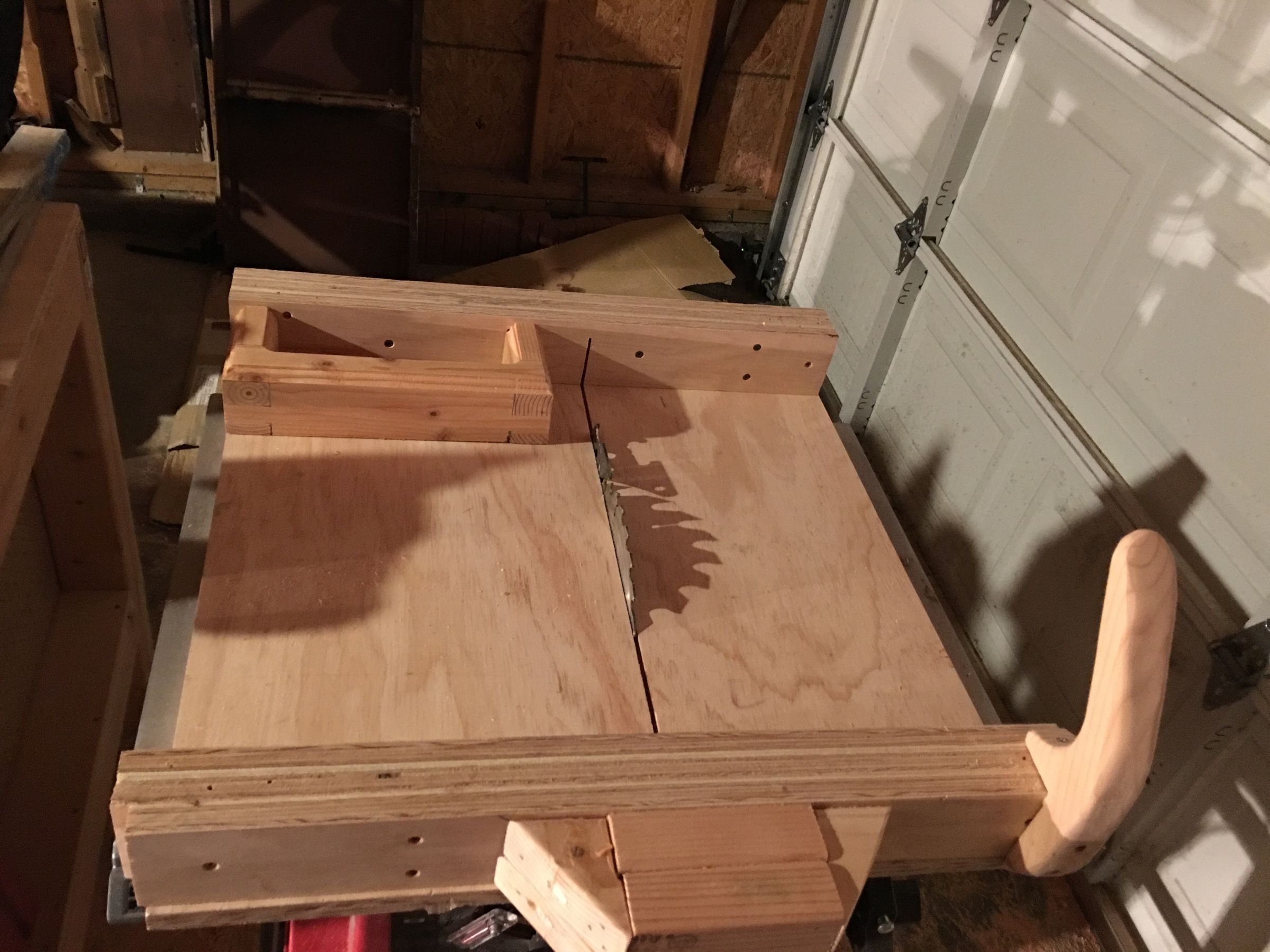

Step 1: First Obviously Get Some Purpleheart
After you get your dirty paws on some wood then cut it down to size and make marks in the middle before you cut the blank so that you can match the grain on the finished pen if you want to. Then mark the centers, I use a center finder and it makes it really easy but whichever way you used it should work s long as you get close enough to the center.
