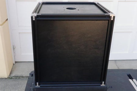

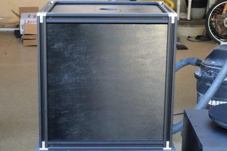

Panels are used to fill the interior faces of the cube. They can be made from a large number of materials, including polycarbonate, plywood, MDF, or aluminum.
When thinking about how big to make a cube, we usually start with how big the panels should be. It is helpful because the material used for the panels may come in a precut size.
In the examples shown in this instructable, all panels are eleven inches.
Step 3: Conventions for Naming
The cube is constructed of two different sizes of beams, long and short. The basic configuration uses four long beams (shown in red) and eight short beams ( shown in green.) All of the sides (two red, two green) are equal, as are the top and bottom (four green).
In the examples shown in this instructable, the bottom is left open.

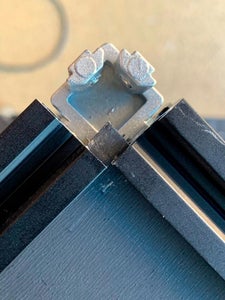

Step 4: A Word About Connectors
The connectors used in these examples are 10 series single tab end fastener clips.
The connectors we use for the 2020 beams are 3-way end corner bracket connectors.
The 8020 series 10 beams will have to be drilled and tapped. The long beam will have to drill on both sides at both ends. The short beams will have to be taped. ( We use 1/4-20 ) Please look at steps 8 and 9 in this instructable for a better explanation. The tab on the connector must be orientated away from the panel, toward the outside of the cube.
The connectors for the 2020 beams have to be screwed into place. The two-prong sides of the connector are always attached to the Long beam in these examples.

Wood can be used naturally or painted. The pictured example has the panels' interior painted with a flat black. The exterior was painted a glossy black. The paint had an integrated primer and was applied as two coats, 45 minutes apart. All cutting and sanding were done before the paint was applied.
This is also a good time to check that the panel used for the top of the cube has notches cut into the corner.

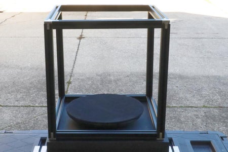

Step 10: Assembly Using 8020
The assemble sequence is the same for both systems, 8020 and 2020. First, build the base, then the sides, and lastly, the top. But because of the difference in the connectors, The order of assembly is a little different.
The base.
For this example, we used an open base, but if you have a panel for the bottom, insert it during assembly.
The sequence of assembling.
- Take all the short beams and attach the connectors to the end.
- Take a long beam and attach two short beams to one end. Stand the assembly upright so that the long beam is vertical. The long beam will have an end touching the work surface. (see the picture.)
- Attach long beans to the open ends of the short beams.
- Place two more short and long beams to complete the square base.
- Insert the side panels
- Place three short beams at the tops of three panels, but wait to tighten them.
- Place the top panel (Make sure you have the panel with the cut corners.)
- insert the last top short beam. It may require a little wiggling.
- Tighten all the screws.

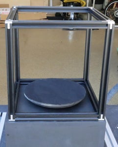

Step 11: Assembly Using 2020
The assemble sequence for 2020 is the same as for 8020, build the base, then the sides, and lastly, the top. The 2020 connectors make the process a little simpler.
- Take four connectors and attach short beams to the single finger on each connector.
- Lay the resulting square on a work surface so that the solid part of the connector touches the surface and the two fingers on each connector are pointed upward.
- Attach long beans to the two fingers on each open connector.
- Take four connectors and attach short beams to the single finger on each connector. Insert the top panel before tightening the screws. (Make sure you have the panel with the cut corners.)
- Attach the top panel to the open long beans and tighten the screws.
