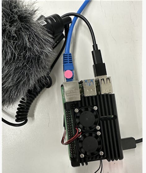

Connect Raspberry Pi
Check out our step-by-step guide:
How to set up your Raspberry Pi 4 for the first time

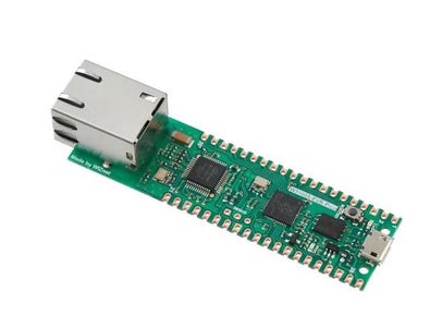

Connect W5100S-EVB-Pico
W5100S-EVB-Pico is a microcontroller evaluation board based on the Raspberry Pi RP2040 and fully hardwired TCP/IP controller W5100S – and basically works the same as Raspberry Pi Pico board but with additional Ethernet via W5100S.

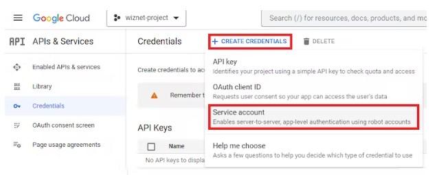

<step-1> [+CREATE CREDENTIALS] select and Service account click

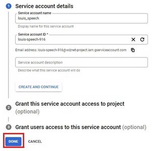

<step-2> Enter a name for the account and press CREATE
<step-3> Verify that the service account has been created as follows:

- Connect the microphone to the RPi USB port and download the Google.spech library for the Google Speech-to-Text service.

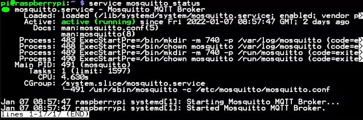

- Next, download and run mosquitto because you will control the device through mqtt. To install the Mosquitto Broker enter these next commands:
pi@raspberry:~ $ sudo apt install -y mosquitto mosquitto-clients
To make Mosquitto auto start when the Raspberry Pi boots, you need to run the following command (this means that the Mosquitto broker will automatically start when the Raspberry Pi starts :)
pi@raspberry:~ $ sudo systemctl enable mosquitto.service
Now, test the installation by running the following command:
pi@raspberry:~ $ mosquitto -v

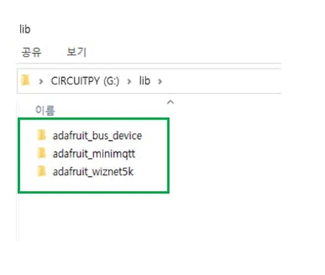

- Setup WIZnet Ethernet Library
Copy the WIZnet library Into the lib folder inside the Raspberry Pi Pico. https://learn.adafruit.com/ethernet-for-circuitpython/circuitpython-setup
Before continuing, make sure your board's lib folder has at least the following files and folders copied over: https://github.com/Wiznet/RP2040-HAT-CircuitPython
adafruit_bus_device
adafruit_wiznet5k
adafrui_minimqtt

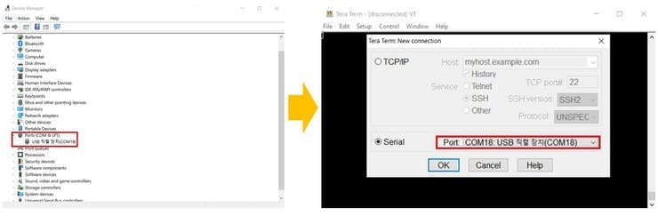

The following serial terminal program is required for MQTT Publish test, download and install from below links.
Before this, you should find the Raspberry Pi Pico COM port number from "Device Manager" on your PC.

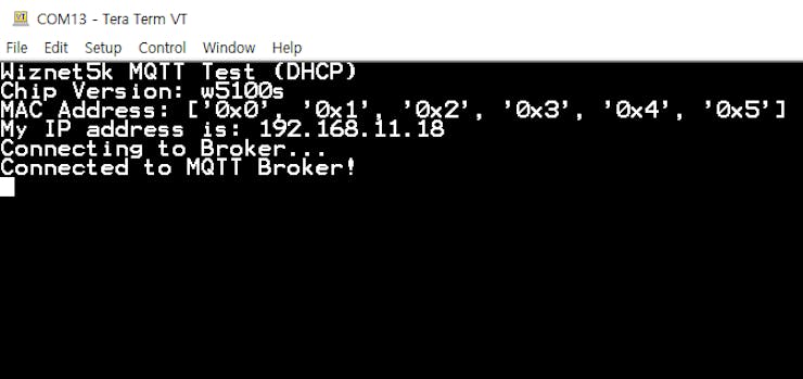

- Paste code into code.py on your Raspberry Pi Pico and Save it. Press "Ctrl+D" on the terminal window. you can see the messages as follows

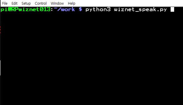

- Execute wiznet_speak.py Python code. I have attached the sauce below

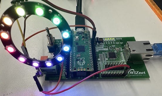

- Let's shout "Hi Pico" into the mic
Rainbow Color
- Let's put the color we want into the microphone
