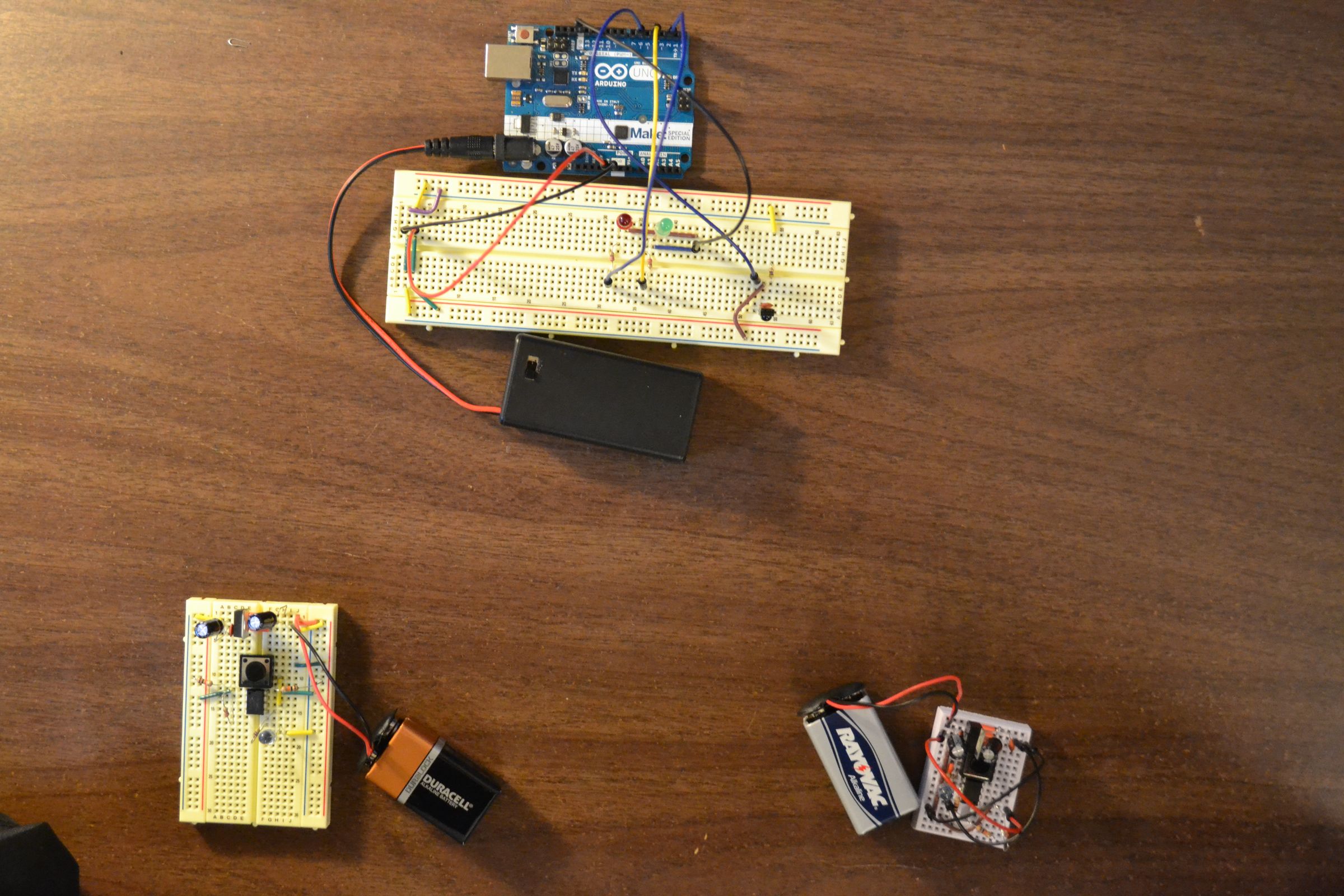

Step 2: The Arduino Way (schematic and Breadboarding)
Setup up the hardware according to the schematics
Then upload the code at the bottom of the page to the board. Test it, and if it works and you're happy with it, then, Congratulations! I guess you're done!
Just press the reset button on the Arduino after each question.

Step 4: Schematic and Breadboarding
Setup the components onto the breadboard according to the schematics. Once you get it working, consider these add-ons.
-Place a 555 timer wired in monostable mode (produces a high output for a given amount of time when trigger voltage goes low) and connect them to the output of the pushbuttons. Connect a piezo buzzer to the output pin of the 555 timer. This makes it beep once if any buttons are pressed.
-Make the pushbuttons into separate little modules that use IR to remotely communicate with the "judge" module. If you would like to do that, take a look at my other instructable "Arduino+Picaxe='robot' umpire!". It's the same idea except that you don't have to place the emitter modules in a glove or base. Also, it only has two "players". To include more players, look up the command "irout" for PICAXE and change the Sony code that will be sent. So player1 would have a Sony code 1 sent and maybe player2 would have a Sony code 2 sent and maybe player3 would have Sony code 3 sent. You will also have to change the code for the Arduino. I just going to be a jerk and let you figure it out yourself! ;)
If you're happy with your little set here, then you are done my friend! You can immortalize it on a perf board and make it nice, if you want.
