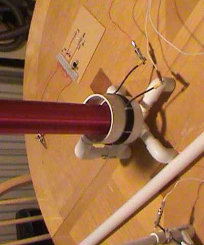

A number of people have asked how I made the Leyden jar array used with the "Tabletop Tesla Coil." In this separate Instructable I offer a detailed explanation of how the battery was made and what it can do.

That's my Leyden jar array. It works well with my small Tesla coils. They're kind of bulky, but lightweight and very cheap. With recycled lemonade canisters, soda cans, and wire salvaged from microwave ovens, these high voltage Leyden batteries are very inexpensive. If you put them together with care, they should last a long time and give good service.
One warning: None of my coils runs at higher than 30 mA. I have never experienced any heating effects with my Leyden jars, but at higher amperages this could happen. Polypropylene is not that resistant to heat. If you are building a fire-breathing coil, this might not be the setup for you.
