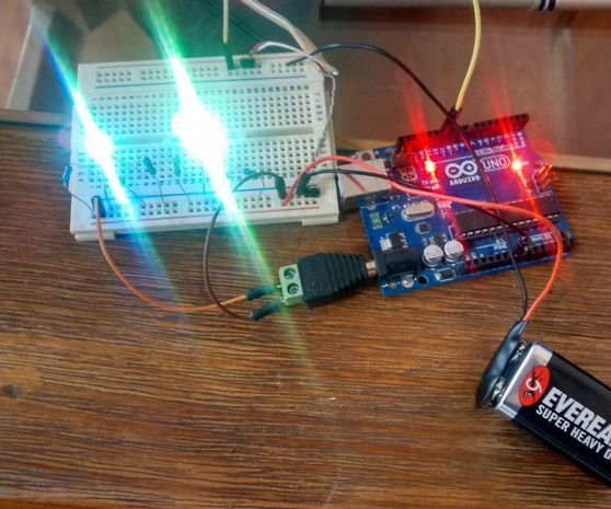

Step 7: Construction of Our LED Circuit
Using RGB LED and with resistance of 1k ohms we can obtain the white color, for the circuit in the protoboard we will perform what is shown in the diagram where we will have the battery of 9V feeding the LED positive and the earth is connected to the signal that sends Our player (music signal). The jackpot ground is connected to the negative side of the LEDs.
Being experimenting I wanted to try another type of color to observe what happened and did not get results with red, green and blue LED.

Step 10: Connection Diagram
Let's connect the arduino earth to the ground of our Jack cable and the positive to the positive 9V battery. The signal will come out of the pin 11 that will be connected to the negative of the battery.
Step 11: Music
Now that we have loaded the code in our arduino and all the connections, it's time to play! We will see how our horn starts to sound without being connected to our arduino, we are simply sending signals through the LED.
