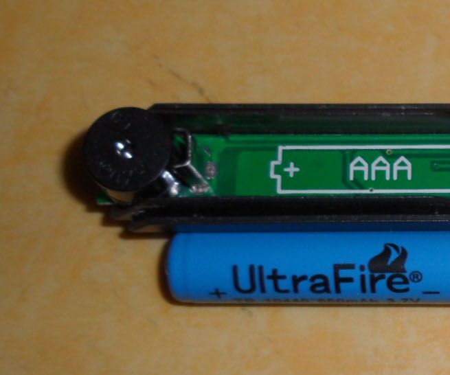

Since of it, I have decided to replace the 9V DMM battery with two rechargeable Li-Ion AAA type batteries.
The way how is pretty simple. You just prepare an exhausted 9V battery. I could recommend an Energizer one because their structure is pretty good to perform this project.
I found a ready made Li-Ion battery pack with charger but I have decided to make it by myself.
