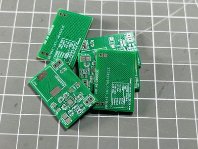

Step 4: Circuit Diagram:

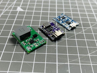

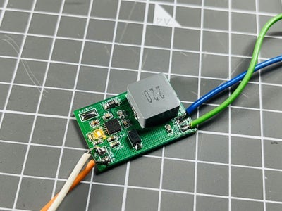

The circuit flow is given in the diagram below, buck conversion is used to charge the batteries. In this way the overall charging process become very efficient and fast. Two pins are given on the PCB to select the battery voltage 1s/2s. In the controlling circuit inductor is used to set the buck frequency and 100mOHM resistor to set the output charging current. This IC supports a max of 2A charging current at 8.4volts. Charging current depends upon the value of resistor, Table for selection current is given on the bottom silk layer of the PCB. Two Led's are used to check the battery status. And the filtration circuitry also plays an important role to reduce the power line and operating noise of the system.

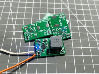

Step 5: PCB Design:
I implement the design by keeping all the noise and stabilization problems in mind. Tracks are made with enough calculations to carry max current hence delivering maximum power and reduce overall heat effects. To keep all the effects of switching section minimal on the input and output the PCB is divided according to the input to output flow. I kept the form factor as small as possible, which makes this design more practical and easier to use as a standalone battery charging device. For input and output connections Solder pads are given on the both side.

Step 6: Assembly Instructions:
When soldering, the best practice is to mount IC first. Then small capacitors, resistor and then Inductor. Because the IC pad has lot of small pins which are very hard to solder with hand. If you don’t want to assemble the board then JLCPCB is the best to option to go with. JLCPCB is the only manufacturer offering SMT assembly services in lowest prices. And we don’t have to worry about the components, JLCPCB can source components from LCSC.

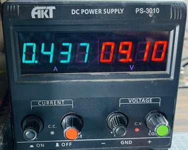

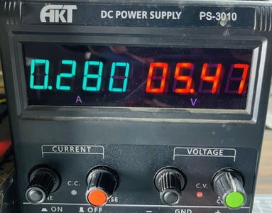

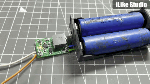

Step 7: Testing:
I have done the testing with 1s and 2s battery packs, as stated earlier this for 2s operation this modules do not support balance charging. So to charge a 2S battery, two identical battery packs can be used from the same manufacturer. The results are amazing in comparison with other battery charging modules. All the protection features of the IC are tested well and in working. For a 1s battery pre-charged at 4.1v the max charging current is measured around 300mA and for 2s battery 500mA. The charging current is small because the batteries are pre-charged and in constant current mode the charging current keep reducing as charging proceeds.
