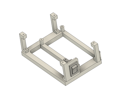

Step 1: DESIGN

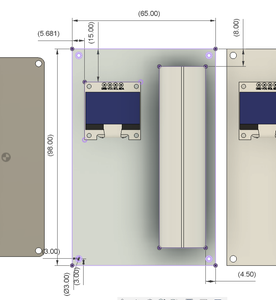

The process of designing the battery charger began with the making of a model for the circuit, which will include an SSD1306 screen and a Li-ion cell holder mounted on a 1.5 mm thick PCB.
In addition, we had to model the circuit for the DC-DC Buck Module, which is mounted on the bottom side, and the main circuit on the top side.

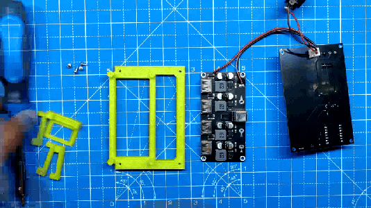

The concept was to use a 3D printed frame made out of a base attached to four mounting pillars, one of which had a holder for a rocker switch, to connect these two circuits together.
Following the model's preparation, we used yellow PLA and a 0.4mm nozzle with 20% infill to 3D print each part of the frame.

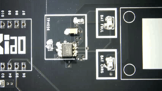

The TP4056 setup is the third and most crucial element of this project. It is a commonly used Li-ion charging IC that is used when we only need to charge Li-ion or Li-Po batteries. Because of its overcharge and overdicharge protection features, the battery voltage is maintained between 2.5 and 4.2 V, which is the optimal range for lithium-ion batteries to operate in.
We have added a CON2 port and paired it with a switch in series to charge the cell. The 5V/3A input of a DC-DC Buck converter will be connected to the entire circuit. Li-ion cells will be charging with a maximum current of 1A due to TP4056, and this maximum current will decrease linearly with increasing battery voltage.

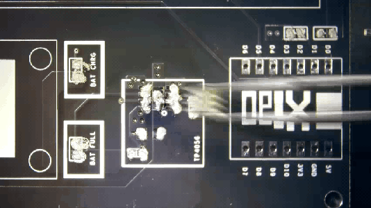

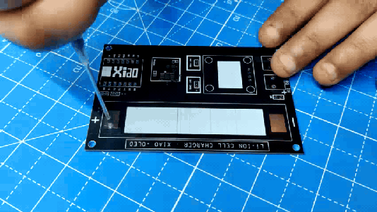

  • Using a solder paste dispensing needle, we first add solder paste to each component pad individually to begin the PCB assembly process. In this instance, we are using standard 37/63 solder paste.

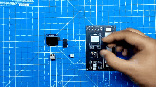

  • Next, we pick and place all the SMD components in their places on the PCB using an ESD tweezer.
  • With extreme caution, we lifted the complete circuit board and placed it on the SMT hotplate, which increases the PCB's temperature to the point at which the solder paste melts and all of the components are connected to their pads.

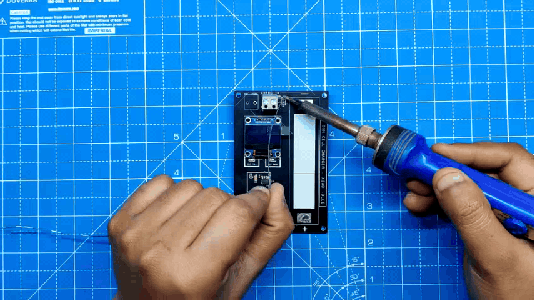

  • Next, we add all the THT components, which include the header pins, CON2 screw terminal, CON2 JST connector, and SSD1306 display, to their locations and then solder their pads using a soldering iron.
  • At last, we added the Li-ion 18650 Battery Holder in its position using a soldering iron.

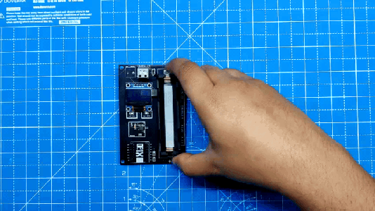

Step 5: RESULT SO FAR

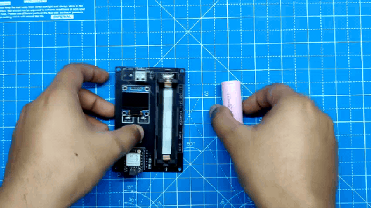

Here is the finished PCB assembly end result: a Li-ion cell charging circuit based on the TP4056 with an SSD1306 display and header pins for an XIAO MCU and Li-ion cell holder.
The assembly is now prepared for the first test after we installed the XIAO ESP32S3 on its header pins.

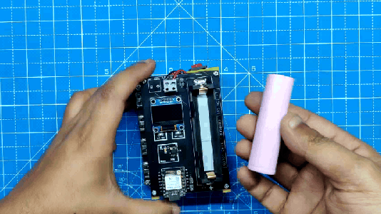

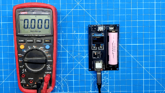

Step 7: TESTING
First, we inserted the Li-ion cell into the battery socket with the proper polarity. It is important to avoid placing the cell in the holder incorrectly, as this could cause the TP4056 to short circuit.
Next, we compare the voltage of the cell with the voltage measured by the multimeter.

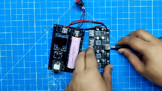

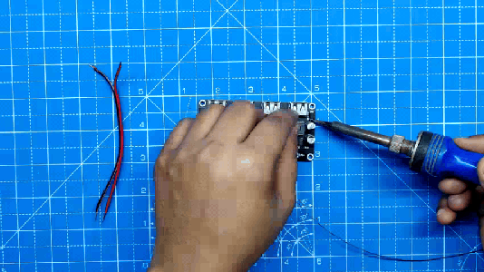

Step 8: DC-DC Buck Module and Charger Circuit Assembly

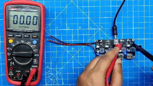

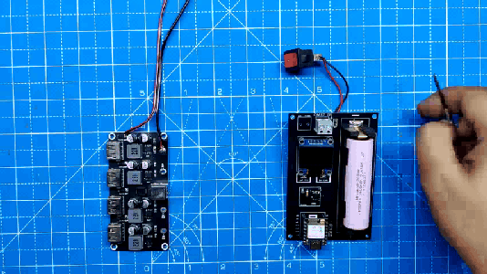

  • Using a soldering iron, we attach positive and negative wires to the DC buck module's GND and 5V terminals before beginning the main process.
  • The positive and negative were then added to the charging circuit via input using a screw terminal connector.
The system is powered on, the OLED turns on, and the current voltage of the Li-ion cell is displayed after 12V is connected through the barrel DC Jack of the DC DC Module.

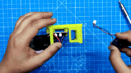

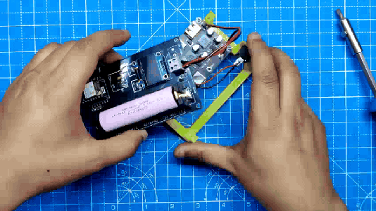

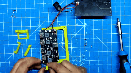

  • Using four M2 screws, we now attach the DC-DC Module to the 3D-printed base.
  • Next, we use four M2 screws to secure the base to the four circuit holding pillars.
  • Furthermore, we connected the rocker switch's JST connector to the circuit and installed a rocker switch on one of the circuit holding pillars.
  • Finally, we position the charging circuit on the top side and fasten it there using M2 screws.
The assembly is now complete.

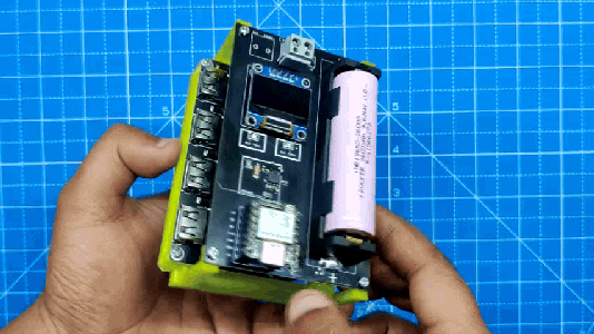

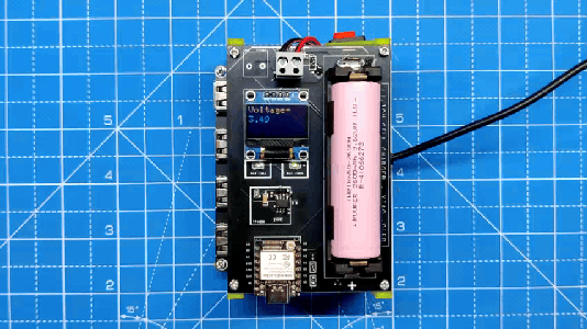

Step 9: FINAL RESULT
The end product of this project is a lithium-ion charger with an integrated battery monitoring system. The voltage of the battery is detected by the XIAO MCU and shown on the OLED screen.
The TP4056 features two indicator LEDs. One LED illuminates during the charging process, and it switches off the full charge LED when the battery reaches 4.2V. In our instance, a blue LED serves as the full charge indicator, and a green LED serves as the charging indicator.
Furthermore, this configuration has four USB ports, each of which can deliver a steady 5V and a maximum of 3A, which is sufficient to power XYZ devices like an Arduino project or a Raspberry Pi.
