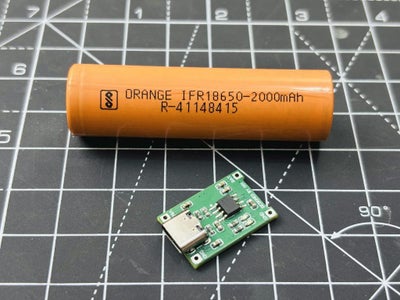

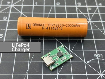

Single cell 1A battery charger, works with LIFEPO4, in the same form factor of the legend TP4056. CC and CV modes with protection features.
  1. CN3058 IC
  2. 0603 LEDs
  3. 0603 5.1K, 2K resistors
  4. 0603 10uf, 1uf, 100nf capcitors

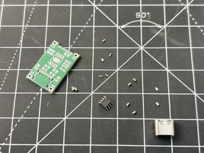

  5. USB Type C
  6. PCB from PCBWAY

I got my hands on a battery from orange, it is 3C rated. Yes it is a little costlier side around 2x a simple lithium ion of same specs. Although I got the same 18650 form factor with a 2000mAH capacity. The C rating 3C here describes the max allowable changing and discharging current. So it looks very similar to our Lithium ion battery and so does our designed charger module.
The charging and discharging characteristics are basically common for this one and lithium ion, but we can’t simply put the same charging module in the TP4056. Because that one is not compatible with the voltage, LiFePO4 has a max changing voltage of 3.6Volts and base voltage is around 3.2 Volts. On the other hand, the lithium ion one has full charge voltage 4.2Volts and rated 3.7V base. This project is sponsored by PCBWAY. I ordered the PCBs from there. They look perfect, I have shared all the information below. It is easy to make project consider if you are looking for a good LiFePo4 Charger.

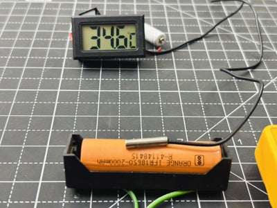

It is listed for 1A, but while testing I found it a little hot around the IC even at 700mA. So I reduced the current and saved my IC, btw it is always considered to use a small heatsink with it.

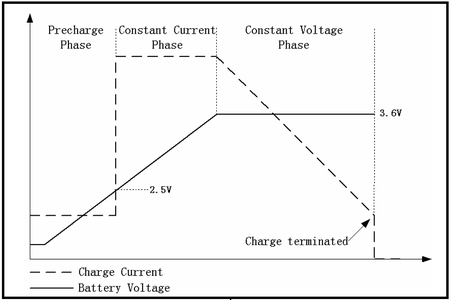

Step 5: Battery Charging Modes:
The CN3058E uses a unique architecture to charge a battery in a constant-current and constant-voltage. The charge cycle begins when the voltage at the VIN pin rises above the under voltage lockout level, a current set resistor is connected from the ISET pin to ground. The CHRG pin outputs a logic low to indicate that the charge cycle is ongoing. At the beginning of the charge cycle, if the voltage at FB pin is below 2.5V, the charger is in precharge mode to bring the cell voltage up to a safe level for charging. The charger goes into the fast charge constant-current mode once the voltage on the FB pin rises above 2.5V.
In constant current mode, the charge current is set by RISET. When the battery approaches the regulation voltage, the charge current begins to decrease as the CN3058E enters the constant-voltage mode. When the current drops to charge termination threshold, the charge cycle is terminated,is pulled low by an internal switch and CHRG pin assumes a high impedance state to indicate that the charge cycle is terminated. The charge termination threshold is 10% of the current in constant current mode. To restart the charge cycle, remove the input voltage and reapply it. In constant current mode the charge current delivered to the battery equals 1218V/RISET. If the power dissipation of the CN3058E results in the junction temperature approaching 135℃, the amplifier Tamp will begin decreasing the charge current to limit the die temperature to approximately 135℃. I will try to replicate the module behaviour using a simple power supply in the next article through which we get more command over constant current and voltage modes.

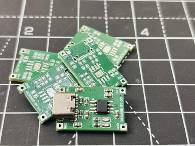

Step 6: PCB Designs:

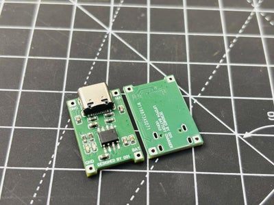

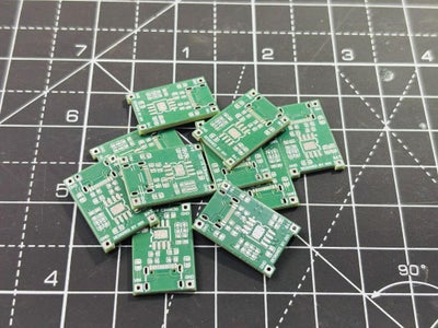

I designed the PCB and shared the design with PCBWAY. It is one of the finest PCB fabricators till 10 years old. It will fulfill all the basics to advance prototyping requirements. I tried to match the form factor to the TP4056 as it sets a benchmark in the single cell charging market. It is the most sold module till date.
I put a type C connector with two 5.1K resistors at CC pins to make it compatible for Type C chargers. This PCB design can be found with all the required files on PCBWAY hub. To assemble the PCBs I am not using stencil for now, but if found difficult PCBWAY also supplies that with PCBs. I gathered all the components and soldered them one by one with my hands. If working with SMT, it is better to have a zoom lens plugged into your camera to see those small pins. Soldering errors might be there!

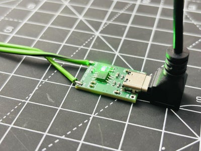

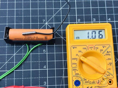

Step 7: Testing and Working:

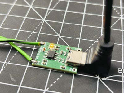

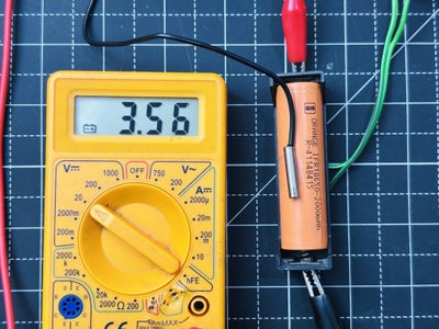

After soldering and assembling the main thing to check if it is working as an aspect or not. To do that we need to check the open circuit voltage at the Vbat terminal. Don’t attach the battery and see the voltage, it should be 1.55-1.65 volts. If not there should be any design error. Btw mine board and circuit is fully tested with Lifepo4, 2000mAH battery. After getting the right voltage on the output terminal, attach the battery and see if it is switching the mode to charging through the onboard indicator.
I attached the battery to a holder and then wired two simple wires from module to battery. Use a type C connector and it works in the first go. If you have any kind of USB meter device available you can test the module more easily. Moreover If you like the content and then join me on patreon. Try PCBWAY services to turn your prototypes into real products.

1) Discharged Battery
2) Fully Charged
3) Charging CC
4) Cut off
