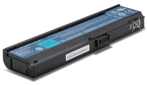

To find the needed laptop batteries for this project, you can look almost anywhere. Ask around for broken laptops or go dumpster diving to find them. I got the laptop battery that I used in this instructable from a laptop in which the motherboard toasted. Since the actual laptop was not in use anymore, I extracted the battery.
Step 2: Extracting the Cells
To extract the laptop cells, You need to use a screwdriver to pry open the battery at its seams. Laptop batteries are glued shut, not screwed, so it makes it a little bit more difficult. After the battery is opened, cut the connections and wires in between the cells to free all the individual cells. After these are free, we can start building the RC battery.
