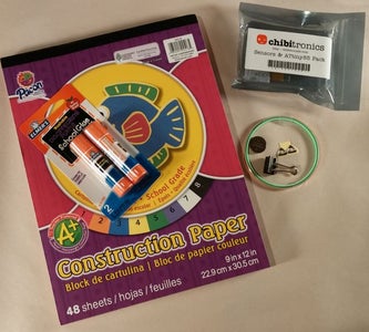

For this project you'll need:
- Sound sensor template
- 2 Chibitronics LED stickers
- 1 Chibitronics sound effect sticker
- Copper tape
- Coin battery
- Binder clip or paper clip
- Construction paper
- Glue stick
- Scissors
- Invisible tape

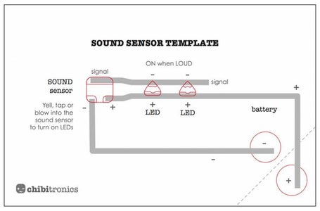

The effect sticker has three corners that stick to the copper tape: one corner is positive (shown as +), one corner is negative (shown as –) and the third corner is called the signal that generates a light pattern. The signal is pre-programmed to affect the lights connected to it on based to the amount of sound that is generated.
Step 2: Building the Circuit
We are going to use the sound sensor template that Chibitronics has created. The space between the lines where the LED stickers go is just 1/4" and using the template has the right spacing. The effect stickers are a little bit trickier when laying out the copper tape since they are farther apart and have three corners.

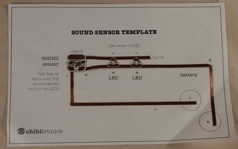

- Start at the + battery terminal until you reach the corner where the tape will turn.
- To make a clean, flat corner, fold the tape away from the desired direction. The sticky side will be up.
- Now fold over the tape, the sticky side will get folded on itself, causing a tight, square corner once you flatten where the tape turns directions.
- Cut the tape when you reach the + corner of the sound sensor location.
- Continue until you have covered all the shaded lines of the circuit.

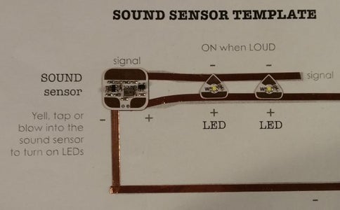

Applying the Chibitronics circuit stickers:
- The LED wide side is the + and the pointed end is the - and easy to get right as the template is labeled
- Pay close attention to the + and - when you place the sound sensor on the copper tape
Testing the circuit:
- Place the - side of the battery on the - battery location
- Fold the paper over
- Attach binder or paper clip
- It should light up when you blow on the sound sensor
