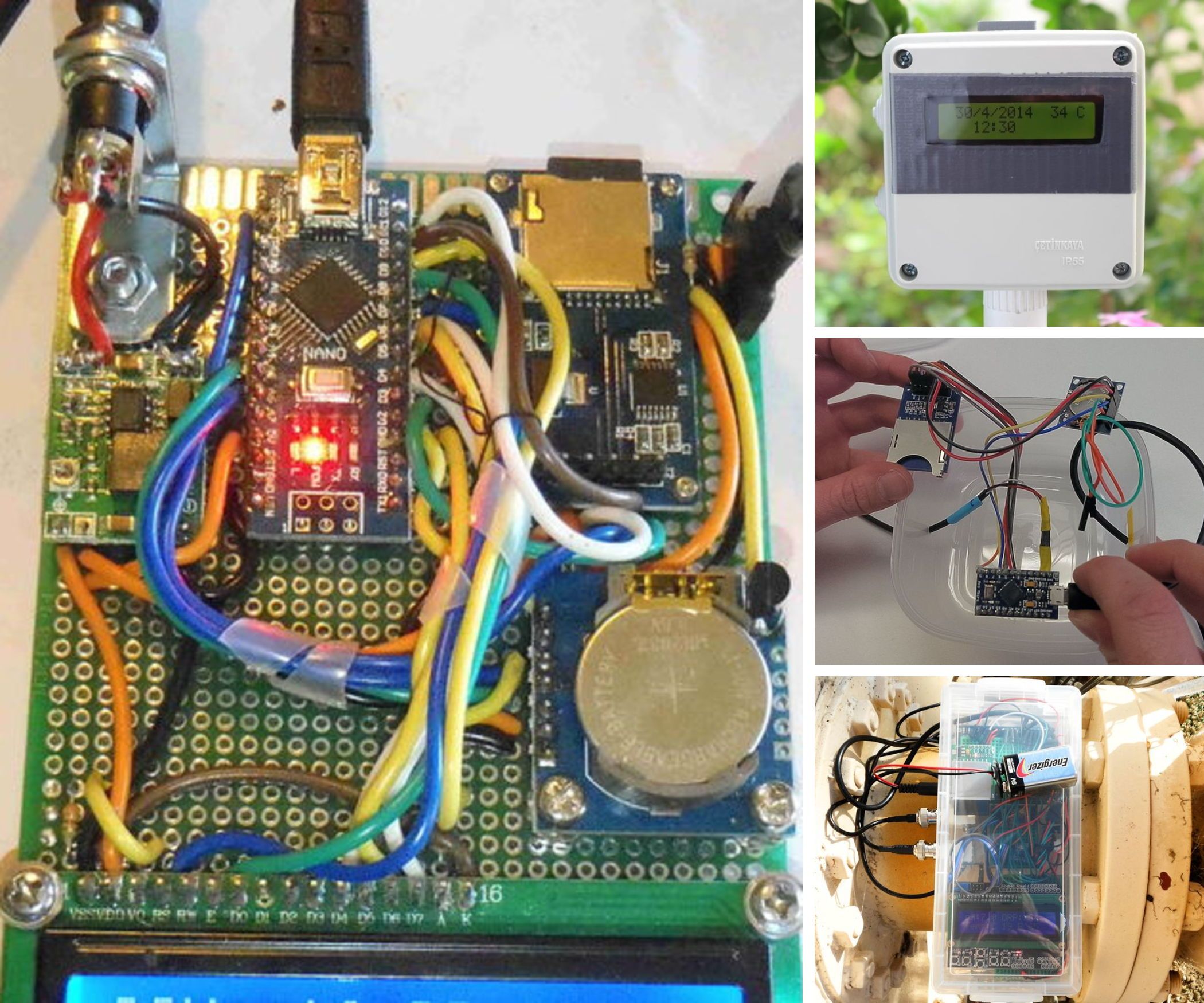

I did not set out to write this library. It "happened" as a side-effect of a project I started that uses a BMP280. That project is not yet finished, but I think the library is ready to share with others.
Subsequently I had a need to use a BME280, which adds humidity measurement to the pressure and temperature capability of the BMP280. The BME280 is "backward-compatible" with the BMP280 - that is, all the registers and the steps needed to read pressure and temperature from the BME280 are the same as those used for the BMP280. There are additional registers and steps needed to read humidity, applicable to the BME280 only. This raises the question, one library for both, or two separate libraries. The hardware for the two device types is fully interchangeable. Even many of the modules being sold (for example on Ebay and AliExpress) are labelled BME/P280. To find out which type it is, you have to look at the (miniscule) writing on the sensor itself, or test the device ID byte. I decided to go for a single library. It seems to have worked out OK.
Feedback, especially any suggestions for improvements, will be appreciated.
