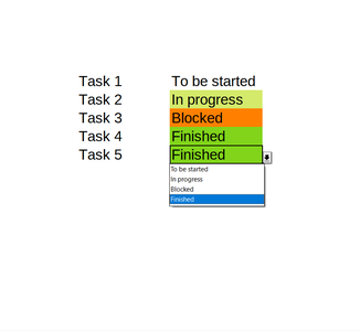

Introduction: LibreOffice Calc: Drop-down Menu for Task Progression Values With Background Color According to Value
This Instructable illustrates how to create a drop-down menu of values
with a cell background color depending on the cell value.

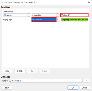

Step 3: Applying the Styles to the Column Containing the Task Progression Values
You can apply the styles to the column containing the task progression values by:
  • Selecting the column.
  • Choosing "Conditional", and "Manage", in the "Format" menu.
  • Relating a cell value to the corresponding formatting style.
Quotes are needed around the cell value.

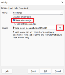

Step 4: Limiting the Cell Values to the 4 Pre-defined Values
Data validation is needed to limit the cell values to the 4 pre-defined values.
Data validation can be accessed by :
  • selecting the area containing the cells where the data validation will be applied.
  • right-clicking on the area and selecting "Data Validation".
  • selecting the pre-defined values.
