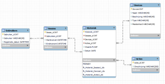

Step 3: Normalized Database
To log and store sensor data I have designed my own database which contains 5 tables.
The EER diagram is shown in the image above.
1.Table Gebruikers
In this table gebruikers I store the users who log into my website.
2.Table Sessies
In these table sessies I store every recording a user makes per user.
3.Table Historiek
In this table history I store each sensor values associated with their session, device and action.
4.Table Devices
In this table devices I store all information about each device.
5.Table Acties
In this Actions table I store which actions there are.
