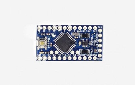

An Arduino can be substituted for the PIC, but you need to do some work to make it happen. I used a Chinese* Arduino Pro-mini - you need a 5V version.
- Program the Pro-mini using the code from my Github repository or write your own. You will need a 10k pot (with a plastic insulating handle) wired Vcc to Gnd and the wiper to pin A3 to alter the PWM signal. The circuit diagram I drew of that using Kicad is in the Github repo too. Original diagram attached

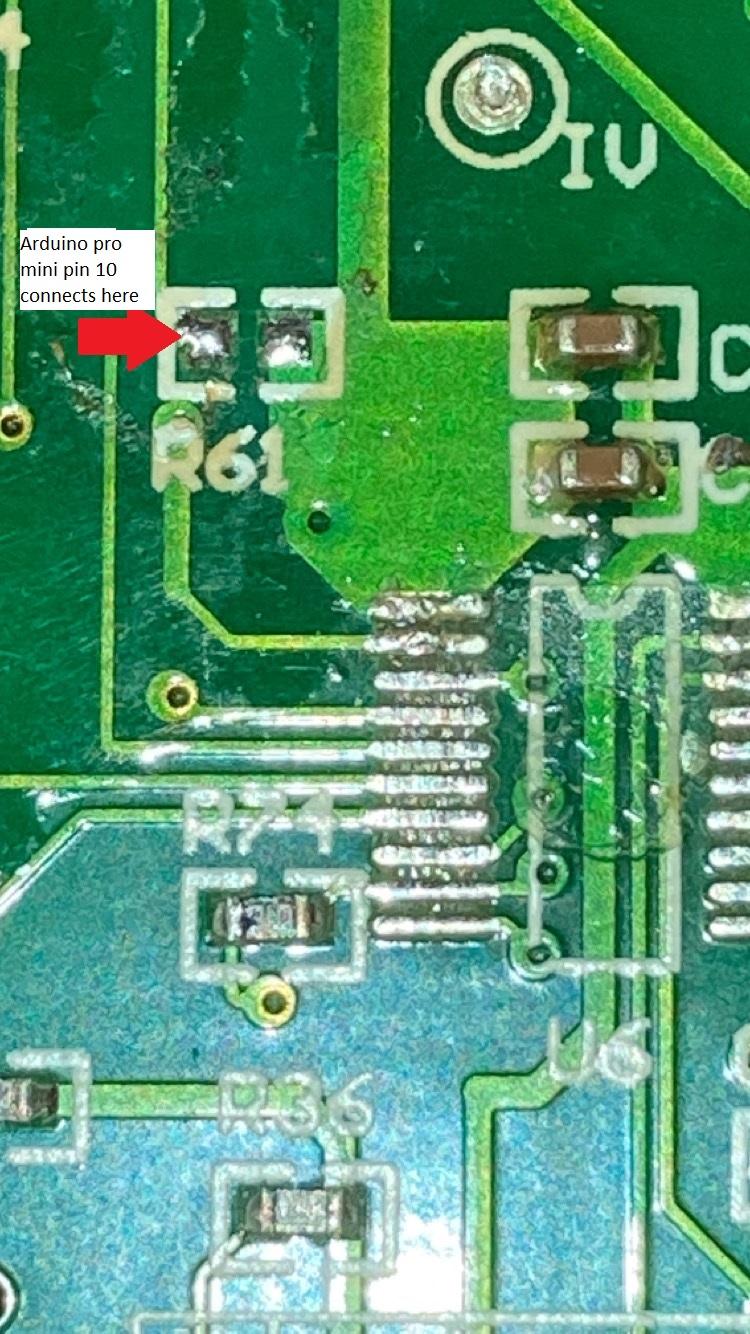

- I'm not certain, but I think R61 pull-up resistor interferes with the Arduino, so remove it. Experiment if you like, not sure of your mileage.
- Remove the PIC
- Under the board install a bridge wire across the RL2 relay contacts (check the photo)
- Assuming you use a Pro-mini too, and use pin 10 as PWM output and pin 13 to drive the totem-pole power signal, wire the Arduino into the circuit as follows (check the photo):
- connect pin 10 of the pro-mini to the pad just above the "R" of R61
- connect pin 13 to the track under the R21
- When I figure out the connections I'll use pin 7 to drive RL2 to close when you want the motor to run.
- Power for the Pro-mini is provided by the gnd-5V pads on the controller board. Make sure you're using "+" 5V and not "-" 5V. Ensure the Pro-mini is insulated from all conductive materials.

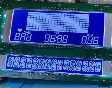

I've tried to separate the "Treadmill controller board" from the "motor controller board" in this Instructable. The former provides a way for the treadmill user to operate the treadmill and has 2 large LCD displays. The latter drives the motor and manages the power supply.
The treadmill controller board has a PIC 18F45J10 - I/SS mounted on it and that drives the displays and the buttons. The displays are beaut and I'd like to try drive them with another Arduino or other microcontroller so I can put what I want on the screen/s, but that's another project.
