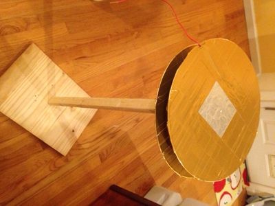

Step 7: Make the Hi-Hat
The backbone of any rockin’ drum beat is undeniably the Hi-Hat. This was probably the most difficult drum to build as it consisted of two “layers” separated by a small stick. I followed these steps to create it:
1. Cover the first vinyl record entirely in duct tape. I would recommend a golden color to keep the cymbal look.
2. Create or obtain a small stick with the same diameter as the central hole in the record and about an inch and a half high. Shove it through the this hole in the first record, and tape it securely.
3. Take the second record and place a medium-sized square of tin-foil in the center. Then lay down decorative duct tape all around it. Remember to connect some wire to the tinfoil before covering everything.
4. Push the connector stick through the whole of the electrically conductive record. Fasten it with excess duct tape.
Out of everything, this is probably the most rickety part of the set. I had to work hard to ensure its stability.
*THE STANDS SHOWN IN THE PICTURE ABOVE WILL BE MADE IN A LATER STEP.*

Step 11: Build the Drum/Cymbal Stands From Scrap Wood and Duct Tape
I happened to have several long sticks of scrap wood laying around in my garage. They were approximately 1 inch in width and 1.5 inches in height. To make each stand I decided to cut the wood and assemble it like this:
1. Make a small mark at the appropriate length, then cut the thin board straight across. The length of each stand will differ according to the person playing the drums and what type of drum you're creating the stand for. Use your best judgement. Generally, the Ride Cymbal should be the Highest and so on in this order, Hi-Hat, Snare, Bass.
2. Drill a hole in the center of a board around 10in*10in*1.5in. It just needs to be wide enough to support the cargo without tipping over.
3. Line up the drilled hole and the vertical center of the longer scrap wood. Place a nail in the gap, and pound in that sucker.
4. Secure the cymbal or drum to the top of the stand at about a fifteen degree angle. Remember, duct tape can accomplish extraordinary things!
5. Solder or tape the short wire coming off of the drum to a longer, more flexible wire. Run it down the side of the drum and duct tape over it. Then beautify the rest of the stand, covering up all traces of the cable. Check out the designs I made in the pictures above!
