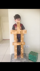

My grandson is a mine craft fan, and for his 7th birthday, he was "dreaming" of having a real minecraft armour stand to put his minecraft helmet on. (from a school “dress up”)
Step 1: Making the Full-size Minecraft Armour Stand.
The model was scaled to 1200 mm high from online photos and was constructed of plywood and pine, made into hollow tubes to minimise the weight but to maintain strength, with a base large enough to resist tipping.
The wooden construction is straightforward , except to say that the pine inserts in the end of each vertical tube need to be accurately made as a push-fit into the tubes.
The painting takes some time!

Step 5: Construction Detail:
There are no step-by-step photos. (construction is simple)
1) Make the base:
The base sides are 4 pieces of wood: 2 x 38 x 38 x 500mm 2 x 38 x 38 x 370 butt jointed, glued and nailed to a piece of 6mm ply 450 x 500mm. It has a piece of 80 x 38 x 420mm wood laterally across the centre so that the screws which secure the “legs” have something to grip onto, and so that the load is more evenly distributed over the base.
The base was made to be detachable for easy transportation. If the armour stand is likely to scratch the floor then adhesive rubber feet can be attached near each corner.
2) Build the boxes:
To simplify construction I used 15mm pine for each 2 opposing sides, and 3mm plywood for the other 2 opposing sides.
Once the wood is accurately cut into strips of the appropriate width (preferably with a table saw) it is cut to length and glued and nailed together into square tubes.
The vertical boxes for each level must be exactly the same length, and any discrepancy should be corrected at this stage.
3) Make the ends for the boxes:
Two 20mm thick end plugs are needed for each vertical box, and they should be accurately cut to ensure a snug fit inside each box. (nominally 79mm x 55mm). The top vertical box and the horizontal boxes have a 3mm plywood “cap” over them rather than a fitted “plug” of wood.
Step 6: Assembly:
  1. The plywood ends are glued and nailed onto both horizontal boxes and sanded flush. Sanding is much easier at this stage, and putting the ends on the boxes adds rigidity.
  2. The boxes that form the horizontal parts of the model should have the 15mm thick sides on the top & bottom so that there is enough wood for the screws to bite into. In the end, it is the PVA glue that will hold it together, but the screws keep everything aligned until the glue is dried.
  3. At this stage, end blocks can be glued into the lower end of the 2 lower legs, so the legs can be screwed to the base when the main body is complete.
  4. Holes big enough for the 30mm screws can be drilled and countersunk at the centre of all the end plugs except the lower 2. These ones will have smaller pilot holes drilled later when the stand is joined to the base.

Step 7: Attaching the Base:
When the glue is dry on the main body, attach the base using 2 x 50mm woodscrews through the 38mm cross beam in the base.:
  • Measure 100mm each side of centre on the 38x80 cross piece,
  • Drill & countersink holes for the 50mm screws. The countersink should be deep enough so that the screw is about 5mm below the surface of the wood
To ensure accuracy:
  • Mark out where the legs should attach to the base using a pencil, or masking tape. It is possible to stand the main body up on the base, and support it or have someone hold it while you mark it.
  • With the main body flat on a table or bench, support the base so that it aligns with the marks.
  • Put one of the screws into the base, and when it is properly aligned with the leg, tap it with a hammer to mark the position for the hole in the bottom of the leg.
  • Put the base aside and drill a pilot hole in the mark you have just made.
  • Retrieve the base, screw the screw a few threads into the hole you just drilled, until it is just firm (not all the way in)
  • Re-align the legs on the base, ensure that the legs are parallel, then tap the screw in the other hole to mark the other leg,
  • Loosen the first screw
  • Drill the pilot hole in the second leg
  • Screw both screws all the way in to legs through the base.
This might seem like the long way around, but it gives more accurate and reliable hole positioning.

Step 9: Painting the Base:
Once all the coats of paint are on the main stand, peel off all the masking tape, fix any glaring errors, re-mask the legs to prevent the grey from the base getting on them, then repeat the paint-mask-mix-paint sequence on the base.
Once all the painting is done, remove the masking tape, and fix any serious errors.
I gave the whole stand a light sand to smooth out the ridges where the tape overlapped the paint, and I put a final coat of satin clear acrylic over the whole model to improve wear, make it easier to clean and to even out the textures.
The armour stand was a great hit at the birthday party, and still gets plenty of use.
It works well for Minecraft armour (made from cardboard boxes) and is also very handy for school clothes....
