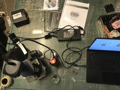

Material: Microscope, Camera that fits with microscope, laptop
Softwares: Processing, AmScope Mu1000
Samples: Potato, fermented carrots, seaweed, moss, lichens

Select the model of your microscope and install the app connected to that model. The microscope we used was a digital AmScope called IAA 11 MSC-01.
When the app is installed, connect your computer to the microscope. Turn on the microscope and open the app. You should be able to see through the microscope on a window on your screen. At this point a sample can be put under the microscope to be examined on the computer.
Use a clean petri dish or a glass slide for the samples of choice.
Samples of potato peel, fermented carrots, seaweed and moss are then put under the microscope.
The sample of fermented carrots we used had been fermented in salt water for four weeks.
We extracted some of the liquid from the carrots as well and added it to the sample.
To use a sample of moss found outside, it is best to take a small sample and soak it overnight in a jar that has a water surface of 1 cm. Then use a water drop tool to gather a sample from the moss water. Try to get some of the sediment at the bottom without disturbing the water too much.
It is important to have the samples on a light background, because it is the contrast of light that is detected by the computer, not the movement itself.
Also note that the surface of the sample should be kept relatively flat because the microscope can only detect one level of depth at a time.
At first the sample is put under 4X, the lowest level of the microscope, where the focus is generally easy to find. A focus is found by altering the proximity of the sample to the microscope and the back light.
It is also generally easier to spot movement on a lower level of the microscope because the camera covers a bigger surface. When a movement is detected it can be examined further using a stronger microscope.
Then the level of the microscope is increased to 10x and 40x by hand without changing the position of the sample. To refocus, decrease the space between the microscope and the sample until the picture is clear again.

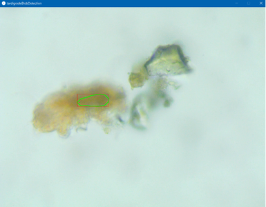

Open BlobDetection code. When you run this code you will see that it is connected to your webcam. There it is detecting dark areas as “blobs”.
(File>Examples>BlobDetection>bd_webcam)
Open the video library for processing 4.This code allows you to run through an example video called “launch2.mp4” by using the right arrow key.
(Files>Examples>video library for processing 4>Movie>Frames)
Through comparing the two bits of code next to each other and gaining knowledge of what they do, we managed to merge the video player into the blob detection code so that the blob detector works on the data from a video instead of the webcam.
You can change what video is being played by simply exchanging “launch2” to the name of the file that you want to run, in the void setup:
	mov = new Movie(this, "launch2.mp4");
Just make sure the file is reachable for the program. Make it reachable by adding the file to the project's sketch file in the “data” folder in your file explorer (Windows) or finder (Mac).
Now you have the base of the code ready and hopefully it detects the areas that you wish by a red rectangle and a green “blob”. From here you can play around with the sensitivity and the visual appearance of the program. This is the base of code.

Step 4: Code: Change Sensitivity and Appearance
The “blobs” are being detected by the program due to contrasting luminosity in the video. The programme's sensitivity to detecting darker areas can be changed by changing the sensitivity threshold. The threshold is the f-number (between 0-1) that somehow decides what is detected.
By playing around with this number the part of the video that is detected changes. We generally had to raise the number to between 0.5-0.9 to get the desired sensitivity. The threshold is changed in the void setup:
	theBlobDetection.setThreshold(0.2f); // will detect bright areas whose luminosity > 0.2f;
We wanted to delete the red rectangle and only keep the shape that resembles the outlines of the micro animal that we found.
This is done in void drawBlobsAndEdges(boolean drawBlobs, boolean drawEdges) where we disabled the part of the code that draws the red rectangle. That can be done by “comment it out using /* (..) */. The forward slash and star tell the program not to read what's written in between them. You can also delete this part but that way it's much harder to undo.
      // Blobs
      if (drawBlobs)
        strokeWeight(1);
        stroke(255,0,0);
        rect(
          b.xMin*width,b.yMin*height,
          b.w*width,b.h*height
To create the effect of tracing the micro animals movement we “comment out” the line of code that creates images of the video in the void draw. That way only the “blob” is drawn on a black background, over and over again, creating the desired effect of tracking the animals movement.
In void draw:
	//image(mov, 0, 0, width, height);

Step 6: Code: Split Screen to See the Correlation
To be able to see the correlation between the movement in the video footage and the generated traces and sounds we decided on a split screen layout as the output of the code.
This was simply done by setting the parameter that defines where on the screen the video is played to the x coordinate that represents the middle of the screen. So based on the size in void setup, divide the x value by 2 to get the middle of the screens x coordinate (in our case 640). In void draw change the x parameter accordingly:
void draw() {
 image(mov, 640, 0, width, height);
 img.copy(mov, 0, 0, mov.width, mov.height,
    0, 0, img.width, img.height);
 fastblur(img, 2);
 theBlobDetection.computeBlobs(img.pixels);
 drawBlobsAndEdges(true,true);
And that's it!
Feel free to try this out and explore your own tardigrade-BlobDetection-drawingmachine-musicInstrument
