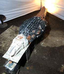

Step 10: Add Scales to Body (part 1)
After adding the sealant coat in the last step, you will be left with a somewhat even, somewhat smooth surface.
Now's the time to get creative! This is my first iteration of scales, which I then altered again and again as I continued with the rest of the gator. It's a matter of getting a detailed enough look, without being too detailed (in which case it will look fake - nature is messy). This is a good time to whip out your reference photo...
This adding of scales and refining them continued throughout the process, so don't get too caught up in making it look perfect. There will be ample opportunity to change and adapt as you go.
Step 11: Add Objects to Body
Begin to use some of the objects you've gathered to add a layer of raised scales on top.
Again, as with the drawn in scales, this is a first stab at it - don't get too attached to anything. Just begin to glue the objects in a line across the center back. If you're feeling ambitious, expand outwards - start with one object layer on each side of the center line. Eventually you will have multiple on each side, but no need to get all the objects on now.
This is where your Rapid Fuse glue comes in very handy - I've found it will attach pretty much anything, although there are some materials that are just too plasticky. In this case you can either discard it or try to attach it using screws (which I did with some materials).
In the third picture, you will see the photo I am using for reference. I'd highly suggest printing out a picture of the animal you are looking to capture, and using it to guide you in your making.

Step 15: Continue Shaping Head - Add Spackle
Once the paper shape you've formed has dried (this may take a while), add layers of spackle to continue shaping the head.
You don't have to be perfect here (as you'll see in a future step, I take a bit of drastic action to fix a mistake), but it's good to be getting the general form the gator's head will take.

Step 19: More Head!
When we last left the head, we were forming more details and working on the proportions.
Now is the time to begin finalizing the shape and start in on details, plus adding some materials (like cardboard or whatever else) to add a bit more structure.
You'll see I carved out a mouth and jaw opening, and shaped the snout a bit more. The last three pics show some of the random materials I've been using to add on to the different parts of the gator.
