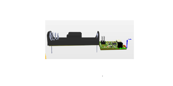

To design a schematic diagram, I have used a CAD software named Altium Designer. For user designing and at the time of manufacturing, it sometimes gets difficult to implement the exact design as per requirement. In order to avoid this inconvenience, I have uploaded all my design files including the schematic file online on Inventhub.

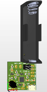

Step 3: PCB
At the time of fabrication and final implementation of the design board, it’s important to take care of routing, board and components dimensions, their symbols, and footprints. I have created my PCB board and then I have uploaded it on Inventhub.
I have created a Release of my project on Inventhub where my whole project is available in ZIP file format. This will help users and manufacturers to reach their exact final design.
