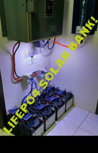

LifePO4 batteries are fairly new for solar use. My home originally used a 24volt bank of lead acid (see pic on the right). These failed only after a year of use. This was a costly mistake. My replacement bank is LifePO4 25.6volt batteries as in the left photo. These I bought off Amazon for 241usd each.
Each battery has built in BMS for under/over voltage protection, cell balancing and temperature safe guard.

Step 1: Connections to Each Battery
For very reduced cost and less materials I soldered the head of a bolt onto one terminal of the switch. This provides a mechanically strong and electrically low resistance connection. To secure the switch to the positive battery pole, just screw in and tighten the nut.
Similarly for the negative battery pole I tightened a nut and bolt. The head of this bolt I soldered a wire directly.
The size wiring is used for each battery is 12awg obtained at a local car audio store. You can of course use a larger cable but the maximum voltage drop when my home draws peak current is 1.2 percent.
Step 2: Metering Per Battery Set.
I have parallel sets batteries per meter to allow a low cost metering solution versus a meter per battery. I have saved on cable costs and ancillary hardware (nuts, washers, bolts, lugs).
Generally if the amp hour capacity of a battery bank drops below 60% of the original value then it's time to replace. The energy meters per battery sets will provide such monitoring.
Step 3: Provide a Plug N Play Means to Deliver Power.
I used two standard nema-15r outlets each with 6 outlets. Please note that this is not a standard use for such outlets however I put a sign up to warn of the purpose of these outlets. The advantages of this arrangement is that I can safely plug in and out any battery group without affecting the rest of the power system.
The connector on the battery side is a two prong polarized nema-15 plug. I chose the bigger blade as my positive. There is no possibility of the wrong polarity being inserted into the receptacles. Safe, high current, readily available and low cost.
The main cable from the receptacles to the DC loads/solar mppt controller is 2awg that came with an old inverter.
